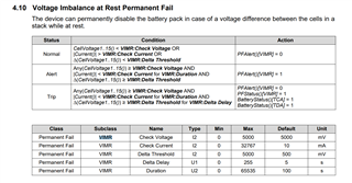

  • Hi Phil,
    Please see the conditions for when VIMR PF sets. Please check the settings in the configuration file for VIMR: Check Voltage and VIMR: Check Current
    Jose Couso

    The VIMR settings are:
    Perm. Fail  VIMR  Check Voltage         3500 mV      0x053e/2
    Perm. Fail  VIMR  Check Current           10 mA      0x0540/2
    Perm. Fail  VIMR  Delta Threshold        500 mV      0x0542/2
    Perm. Fail  VIMR  Delta Delay              5 s       0x0544/1
    Perm. Fail  VIMR  Duration               100 s       0x0545/2

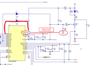

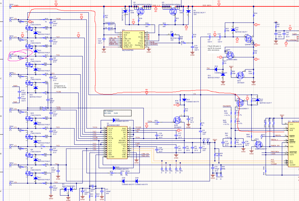

    Here's our circuit which has Bat connected to he highest cell.
    However if a fault occurs with the battery cell connections (eg an open circuit) this no longer always holds true.
    Say we have ~4.07V on each cell. The sum of C4 & C5 is ~8.14V.
    But lets say vibration or shock has broken the connection to  C4, we no longer get a reading of 4.07V on C4 & C5 but some other value. Such as ~1.478  & ~6.109  from the example above, which does not equal 8.14 is is 7.58. This can be explained I believe by considering the paths mention in SLUA749A section 10 - Random Cell Connection.
    The sum no longer matches the BAT pin. However the BAT pin voltage shouldn't change.
    This is why I'm interested to know the true source of the PF Bat Direct Voltage Register at eeprom offset 506 (0x01fa).

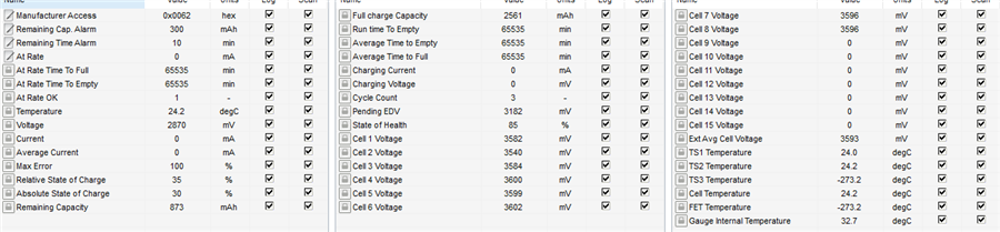

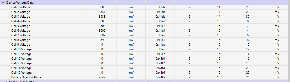

    Here's some data from a battery were I initiated a PF by inducing of Over Temperature condition (decrease NTC resistor value to safely trigger the failure)
    Sum of the voltage is: 28729.
    I'm guessing bat direct is in units of 10mV for Battery Direct and not mV, but I could find documentation to confirm this.
    The live voltage is is 2870 which is in units of 10mV for our setup.
    With the sum of the cell voltages a equal 28699mV
    The Avg Cell Voltage (Bat pin) is 3593mV which is in the middle of the cell voltage so looks ok.
    So the PF Bat Direct Voltage in this test does not match the sum of the cell voltages exactly.
    This leads me to believe it is a calculated form something.
    Perhaps the Ext Avg Cell Voltage * number of cells / 10????
    Or something else altogether????

  • Hi Phil,
    It looks like battery direct voltage is a direct read from the AFE. Can you probe on the BAT pin of both the AFE and BQ78350?
    IT should be by default in units of 1mV. Can you check the gain in calibration window? Maybe this is a calibration issue.
    Jose Couso
