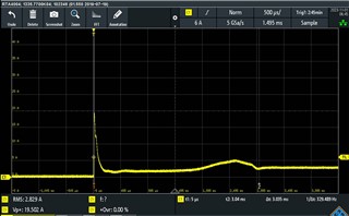

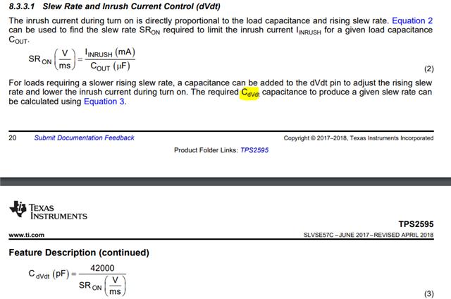

My customer is looking for a product that has the ability to limit inrush current.
The inrush current measured on the primary side (power connector) of the 12.5V / 2.1A module is as follows.
They want to limit the inrush current, which is about 18A, to around 3-4A. For this, they are considering using the TPS1H200A-Q1 or TPS2640.
Are these products suitable for their purposes?
If there is a product that better suits the function the customer wants, please recommend it.
