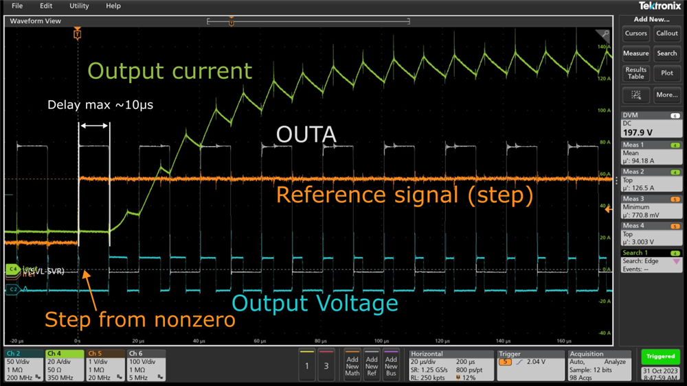

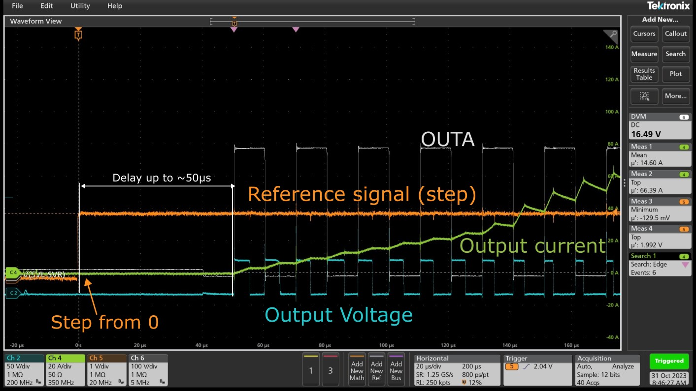

The problem arises when increasing the input reference (EA+) from below the switching threshold(~0.8V) to a higher value. This results in a delay of approximately 50µs before the converter begins switching, which is not suitable for the intended application. This can be seen in the following image:
However, when the reference step is initiated from a higher level where the converter is already in operation, there is no noticeable delay.
I suspect that this issue may be related to the burst mode function of the converter. It's possible that the converter initiates in burst mode when starting from zero and takes some time to transition out of this mode. This might be a wrong assumption.

    As i attempted to explain earlier, the "reference signal" is what I'm feeding as a reference to the converter. This goes through an amplifier circuit, which adds an offset and a gain. The converter has an internal PWM comparator comparing the EA+ signal to a ramp going from 0.8V to 2.8V. Therefore, the converter should only start switching once EA+ hits 0.8V.
    In the bottom plot, there is switching before stepping. This is intended, as to show a step from above 0.8V on EA+, to a higher voltage. The upper plot shows a step from below 0.8V on EA+ to a higher voltage.
    So what I'm seeing, is if I perform the step from no switching -> switching, I see a delay.
    If I step from switching -> switching, there is no delay.
    Hope that clears things up.

    The problem is still that there is a difference in how quickly the converter reacts to a step reference when starting from zero, compared to starting from a non-zero reference. The question regards the load step response delay of UCC28951. The response time when stepping from no load reference to full load differs significantly from stepping from low load to full load in our measurements.
    I have measured the CS signal, and this is not the issue. There is no signal on the CS pin, since no current is flowing.
    A step response from low load only has a delay of half switching period, while when stepping from no load it has a delay of 2-3 switching periods. For our use case for this controller, this is unsatisfactory. We need to get the delay in the load step response from no load down to max 1 switching period.

    I think when you are at no load the comp output will go as low as it can.  When you demand a load the comp starts from a zero condition and will have to climb to a voltage where the converter is demanding a duty cycle greater than the minimum on time programed by Rtmin.  You should be able to verify this by looking at COMP, CS and the input of the transformer.
    1.  I would test it with light load to full load where you mentioned there are no issues.
    2.  Then test from no load to load where you see the issues.
    3. When you compare the two test conditions it will come apparent.
    If you need a fast transient you may be able to pre-load the output to ensure a minimum duty cycle is maintained under no load.  So that when you converter demands greater load there will be no delay.
