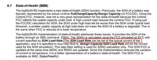

Our customer feedback a battery for power tools and we have problem of the SOH 93% dropping down below 60%. After we received the battery and read it with bqstudio, the SOH has returned to 100%, not 69%. We can't reproduce the drop of the SOH, so what could be the parameters or events that will cause a recalculation of the SOH by the system?

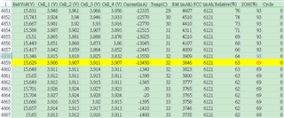

As below data log is drone feedback :
Discharge 12.5A SOH 93% drop to 69%.gg.csv
