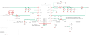

Hello, we are in pre-production with a charger that uses the BQ24123 or BQ24125 (we have two variants of our design to address possible chip shortages).
We have been testing our charger for over a year with no issues, but this week a tester reported that when they installed a battery with low voltage (~7.3V), the STAT2 LED (charge complete) turned on immediately and the battery never charged. Upon reinstalling the battery, the system operated normally.
Our design uses three pogo pins, +, -, and NTC. The system is designed so that the NTC pin makes contact last (ideally).
Is there any explanation for how the BQ2412x could have mistakenly gotten into the charger complete state?

    What is the battery cell count of your design? What is the maximum battery voltage?
    Was the battery reinstalled immediately after?

    I have not seen this issue in the past.  Is it easy to recreate?  If so, can you get a  scope capture of BAT and IIN when the battery is plugged in?  You might want to add a small capacitor at BAT to help prevent overvoltage spikes at hot plug of the battery.

    This fault was reported by a test user who was using a charger with a different charge IC that we have since moved away from. I apologize for the mistake!
