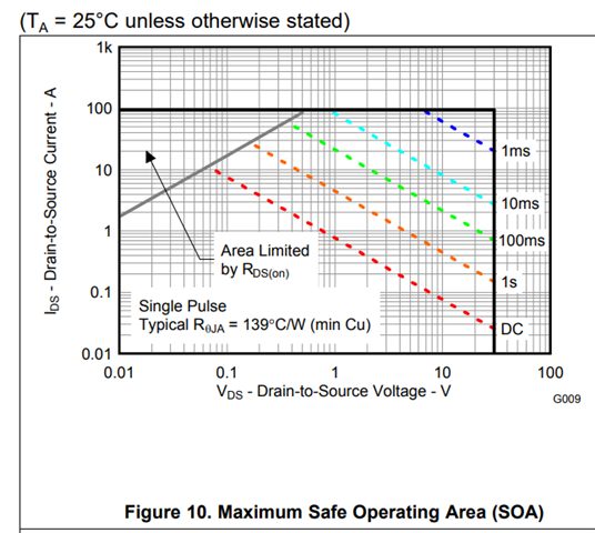

Is possible to provide TPS55288 internal MOSFET SOA figure likes below?
Thanks!
Jeff

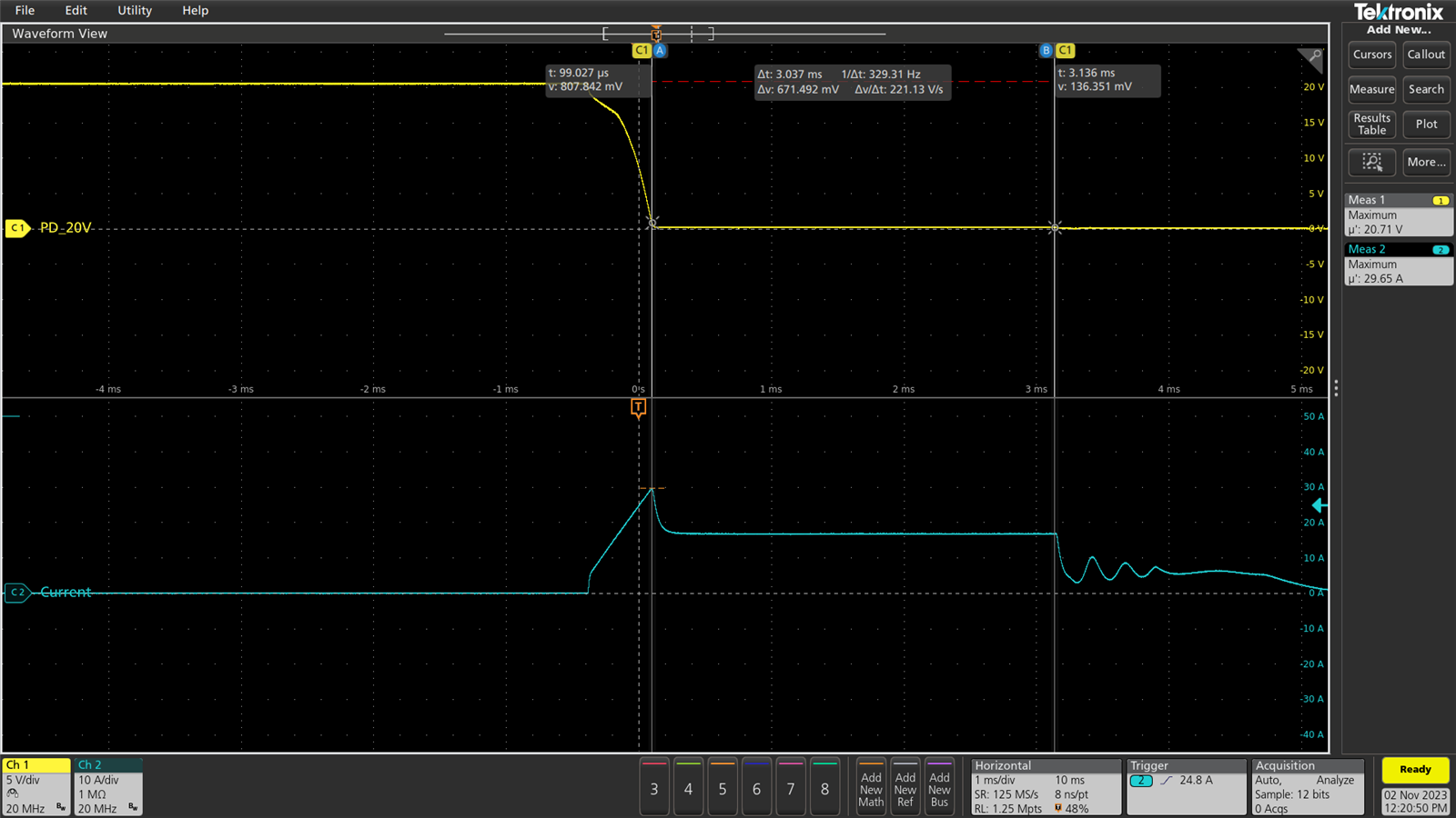

Thanks for the background, may I know if the current is the inductor current?
What is the input voltage and the output current when do the Vout short to GND test?
And how does the customer do the short test? Use a air-switch or e-load?
Does the customer test on TI EVM? Because I saw the current uses about 500us to rise to 30A. Can the customer also probe SW1 and SW2 waveforms when doing the test?

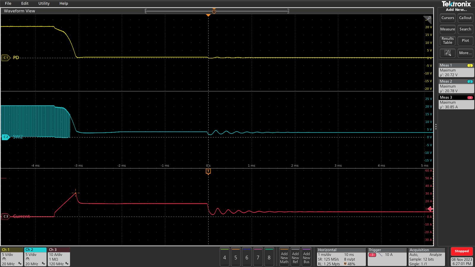

Hi Bryce,
1. may I know if the current is the inductor current?
=> output current
2. What is the input voltage and the output current when do the Vout short to GND test?
=> input voltage= 20V, output current = as previous waveform.
3.And how does the customer do the short test? Use a air-switch or e-load?
=> e-load

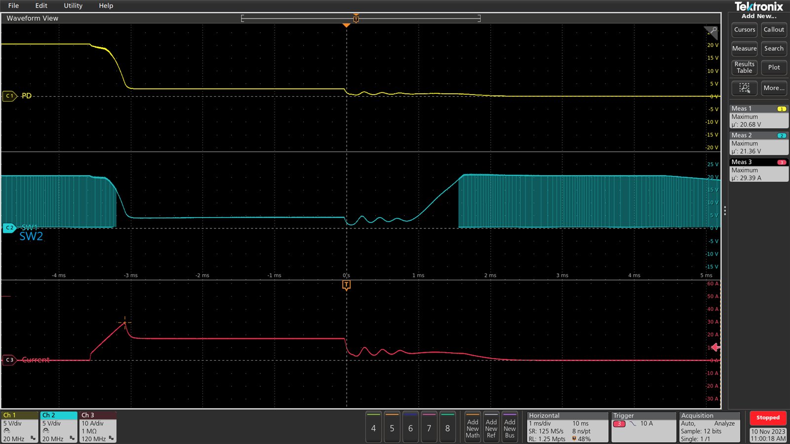

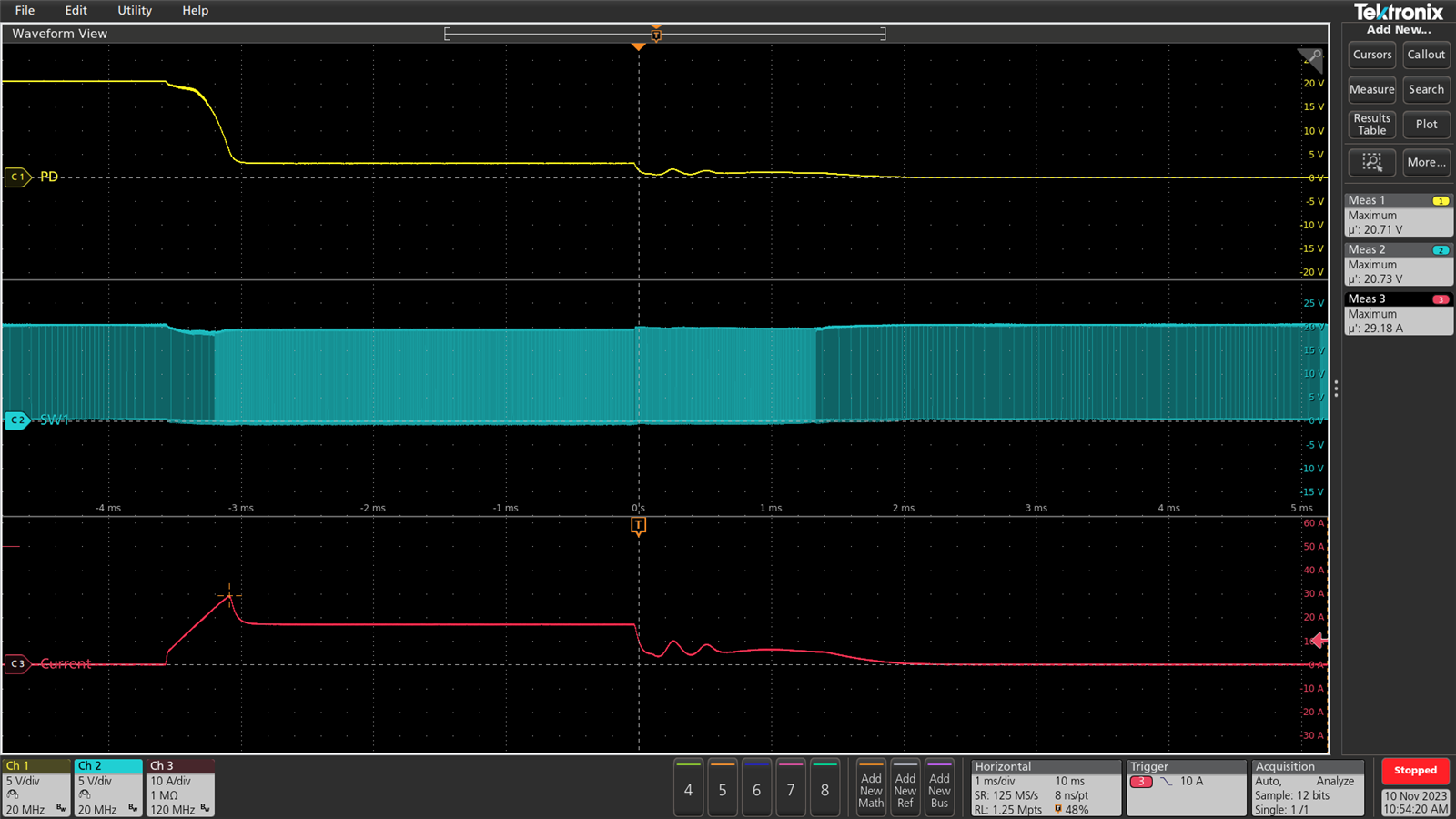

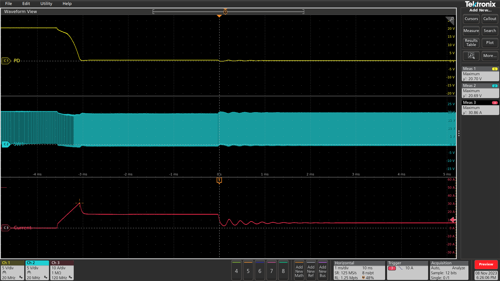

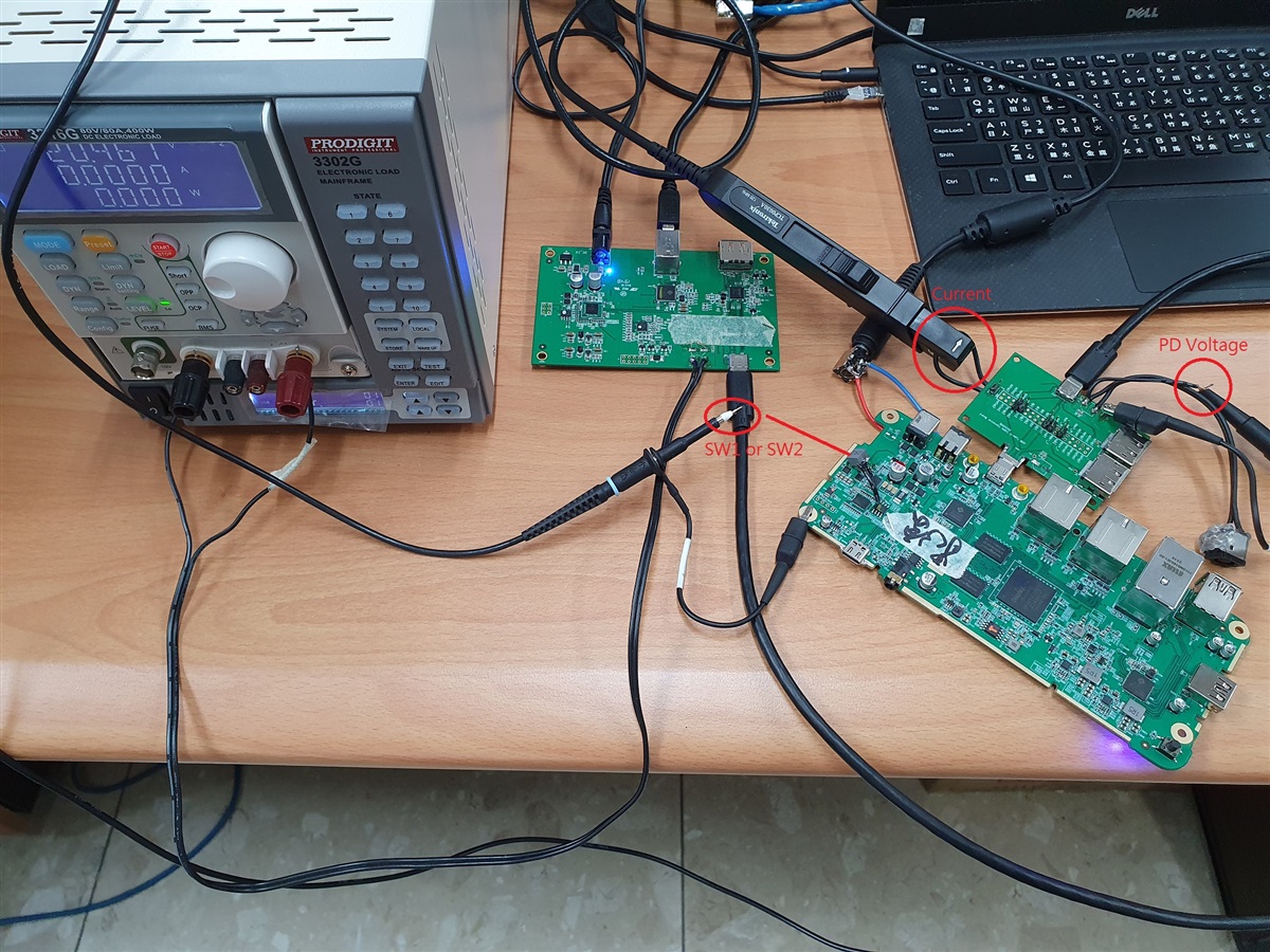

4. Does the customer test on TI EVM? Because I saw the current uses about 500us to rise to 30A. Can the customer also probe SW1 and SW2 waveforms when doing the test?
=> On customer own board. For SW1/SW2 as below.
Thanks!
Jeff
Hi Jeff,
I will do the test with TI EVM on lab together, it is strange that when PD voltage is zero but SW2 still remains 4V, is there is a long wire between Vout and PD? Can you share the schematic and layout for the customer's board?

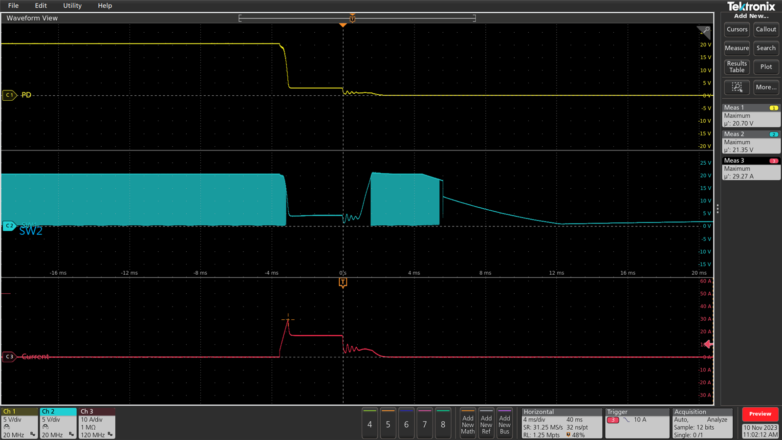

Hi Jeff,
Can you also share the schematic and layout screenshot?
And can you help probe the inductor current when the output current rises to 30A?
Can you also zoom in the waveform including SW1, SW2, iL, Vout when PD=0 but SW2 is switching? That is strange that PD=0 but SW2 still equals to 20V. Which test point does thecustomer probe at? Can you take a photo and show the test point?

Hi Jeff,
The inductor current is well limited at about 16A as the schematic ILIM set, what about changing another e-load and do the test again?
And I think the customer doesn't need that high. May I know what is the customer and the output power here?
Also, does the customer disable the output current limit function of TPS55288? Because the output current is high.
BRs,
Bryce
Hi Jeff,
Is there any more feedback from the customer about this? For TPS55288, the inductor current is well limited as set, and looks ok. Recommend to enable the output current and change the ILIM resistor to 40k to set lower average inductor current limit value.
