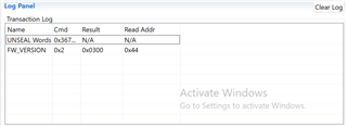

Confirmed TI FW Version is R3

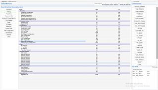

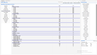

Cell Balancing Configuration
Balancing Configuration Register

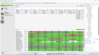

Cell Balance bit in Operation Status not set
