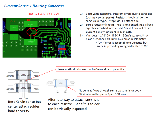

  • It seems that the issue is coming from the current sense layout. The recommended layout is shown below.
    Could you please measure the differential voltage drop across VIN and SENSE pins using a multimeter while 10 A load current is applied?

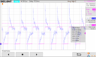

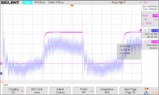

    I believe that our problem is voltage spikes on the sense voltage waveform that occur at the transitions of the current pulses. See the following oscilloscope traces. Channel 1 is the Vin to Vsense voltage fed to the LM5069 and Channel 4 is the current flowing through the sense resistor.
    We have a 0.1uF bypass cap at the output of the LM5069 and the load capacitance of 1500uF is located about 4 inches downstream from the LM5069. We had tried increasing the local LM5069 output capacitance to 22uF, but the circuit still limited at just under 15A. The only difference noted was that it now took longer for the timing cap to charge to 4V and current limit the LM5069 than it did without the extra 22uF.

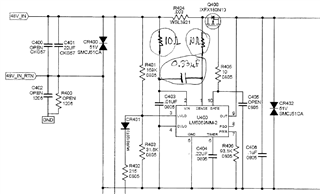

    So we tried to filter the spikes out of the signal fed between Vin an Vsense in the LM5069. We cut the sense lines between it and the sense resistor on our PCB and inserted a 10 ohm resistor in each line. Then we inserted a 0.33uF capacitor across the Vin and Vsense inputs of the IC. This removed the spikes from the Vin to Vsense inputs of the IC and caused our current limit to increase to acceptable limits. See filtered signal in plot below.
    Below is a schematic of the filter we added.
    Although we obtained beneficial results, is this type of filter configuration compatible with the current sense amplifier in the LM5069?
    Please let us know. Thanks.
  • Hi Lee,
    Thanks for your detail explanation. Placing a RC filter is recommended across the current sense resistors to filter out the noise from the sense pin. Please remove the resistance from the VIN path. The resistance only on the SENSE path and the ceramic capacitor are fine in implementing a first order RC filter across the sense resistance.
  • Thank you Avishek. We modified our filter according to your direction and have obtained acceptable results.
  • This satisfies our question. Thanks for the help.
  • Glad to know that your problem got resolved. Thanks for your patience.
