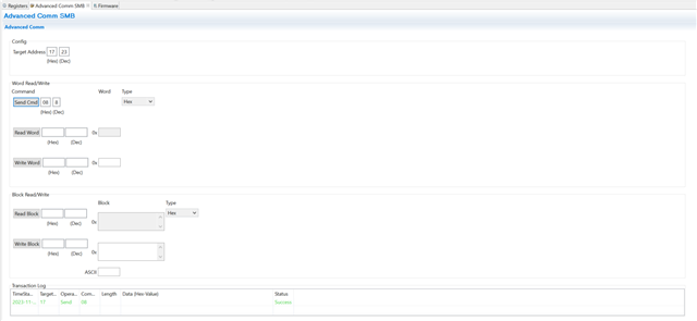

  • Hi Wyatt,

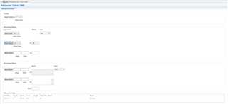

    Is there a way to confirm whether or not I'm in ROM mode? I tried sending the SMBus command 0x08 and reading the SREC multiple times, but I encountered the exact same sequence of events documented in the original post. I have attached an image of the successful command being sent. Let me know if it looks like I did anything wrong and what to try next.

  • Hello Nathan,
    Please read word 0x0D and see if the result is around 0x9000, if it is then the gauge is in ROM mode. There are integrity bytes as part of the FW upload process and if they are not valid (from bad SREC upload) then it will not boot to firmware mode.
    Sincerely,
    Wyatt Keller
  • Hi Wyatt,
    It looks like the BQ40Z80 is not in ROM mode, I read word 0D and got the value 3E back. After that I attempted to read the SREC and got the same issue mentioned in the original post. After the re-flash to recover from everything breaking I am still reading 3E, so it appears to consistently not be in ROM mode.

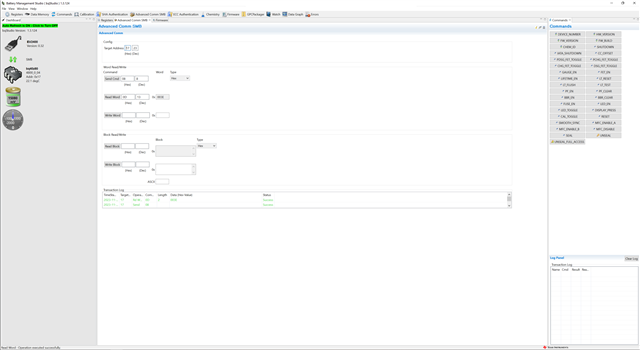

  • Hi Wyatt,
    That testing was done on the latest stable version. I have now installed the latest test version and done some testing with it. Below are some notes and screenshots.
    1. The BQ40Z80 was autodetected (without installing the additional support for it that I need to install on the stable version)
    2. I read word 0x0D before and after sending the command 0x08 to exit ROM mode. Both times the response was 0x003E, so I do not believe the BQ40Z80 is ever in ROM mode to begin with.
