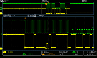

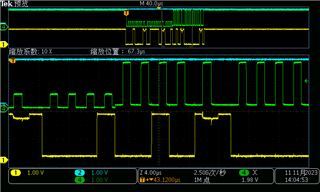

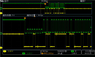

Hi,TI team, we use BQ76952 to design a BMS For 48V battery, and confirm that this chip is the default I2C without CRC. After the overall power-on, we send 0x10 read command to the chip by simulating I2C communication through IO port, and no ACK response is found. Even the SCL level was clamped to about 1.1V in the first few cycles (the chip power supply was 3.3V), and it was found through the simulation device that the single-step simulation showed that the clamped cycle time was variable, sometimes 3-4 clock, sometimes longer, but after that the SCL output level was normal, and no rule was found in this multiple tests. Repeat sending 0x10 for many times and there will be an ACK at some time. However, SCL will be lowered again when the following steps are followed by writing the address of the register that you want to operate, and no ACK response has been checked
the chip wake-up state. During the communication process, the REG18 waveform is measured synchronously and the level is maintained at about 1.81V.

CH1:SDA   CH4:SCL
The following is the 0x10 write exception:
In the following figure, an ACK is available after send 0x10, but subsequent exceptions occur

  • Hi Zhiwen,
    This looks very odd. Could you take these same waveforms again but including the 3.3V_D waveform as well?
    Also, since the issue is with the clock, it may be a problem with the MCU.
    One last thing, you may want to check for any accidental shorts on the board.
    Max Verboncoeur
  • Hi Max,
    This is new waveforms with 3.3V_D(CH2,blue), it stay 3.3V when communication. I have also suspected that the MCU is faulty, but the MCU is only configured as GPIO, it can only output high(3.3V) or low levels(0V), can not output 1.1V, so I think it's probably not about the MCU.
    I tested it with other boards and the results were the same, whereas I'll check the board for shorts

  • Hi Zhiwen,
    Your schematic doesn't seem to have any issue, and I've never seen the BMS device do this. You may want to confirm that there is no issue with the board itself or with the MCU, as the MCU is the source of the clock signal. Although it's unlikely this is the cause, one thing to check is that the MCU supports clock stretching; this is one of the most common I2C issues I've seen.
