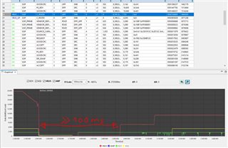

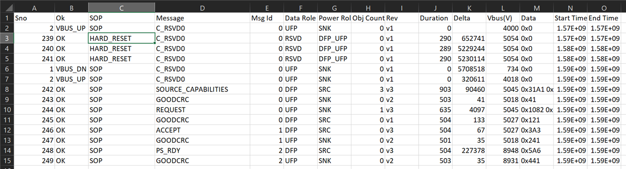

  • Hallo Alex,
    I followed exactly the test procedure in your last replay.
    This is the collected data form the PD analyzer.
    First I did the test with a powerbank
    PowerBank_BarrelJackTest.csvPowerBank_BarrelJackTest.zip
    In Line 18 I do the Barrel Jack connect.
    In Line 28 I do the Barrel Jack disconnect-> There is no visible response at the PD Analyzer.
    What I see is at the Application Customatisation Tool in Debug Mode the Dead Battery Flag is changing from TRUE (No Barrel Jack connected -beginning of data collect) to FALSE (Barrel Jack connected Line 18) to TRUE (Barrel Jack disconnected Line 28)
    The EVM is always in SINK mode, and the powerbank is always in SOURCE mode, no role switch is taking place.

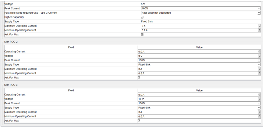

  • Hi Klaus,
    From the PD logs, it looks like the TPS65987 is hard resetting, possibly when the barrel jack event occurs. The hard reset is a message from the far-end to the TPS65987.
    Since you see the dead battery flag changing from True to False, this means the barrel jack event is triggering. However, no PR_Swap is sent, possibly because the hard reset occurs. I will look into why the barrel jack event can trigger but the PR_Swap request is not sent. In the meantime, can you change the S4 dip switch setting to BP_NoWait? You can do this by having switch 6 only in the on position, all other switches off. The dead battery configuration set by ADCIN could be influencing barrel jack event behavior.
    Please test with the BP_NoWait configuration and let me know of the result.

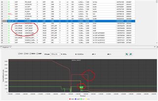

  • Hallo Alex,
    as requested I tried the BP_NoWait - S4 switch setting with the above test scenario.
    It behaves different but not the way I was hoping. Also no role switch between sink and source with Barrel Jack plug / unplug.
    What worrys me is that EMV behaves different every time even when I do the same test scenaro.
    So with exact the same test set up and the same test scenario the EMV behaves different.
    Here are the 3 most commen ones:
    Powerbank_BP_NoWait_2.csvPowerbank_BP_NoWait_1.csvPowerbank_BP_NoWait_3.csv
    For me this is really strange.
    That also makes testing very difficult if you can not trust the outcome.
    BR Klaus

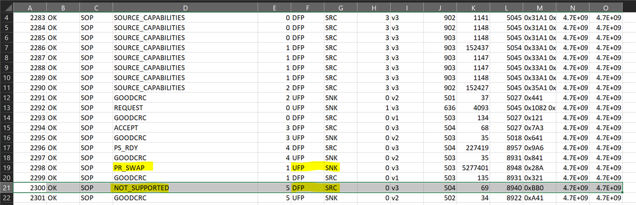

  • Hi Klaus,
    The behavior difference in the three logs you sent look like they could be caused by the far-end sending a hard_reset to the TPS65987. I broke down the behavior I see below:
    In logs 1 and 2, the TPS65987EVM starts as the Sink and UFP. It detects the barrel jack connection event and sends a PR_Swap request to the far-end. However, in each of these two cases, the far-end responds with a "Not Supported" message. Meaning the far-end device does not support power role swaps to a sink power role. The TPS65987 works as expected here.
    In log 3, at the beginning we see some hard_reset messages that may be altering the behavior. The TPS65987EVM once again starts as the Sink and UFP. This time, no PR_Swap is sent following barrel_jack connection. Is anything at all different between the tests in case 1 and 2, and case 3? Was the same far-end device used?
    In neither case 1 or 2 do I see the TPS65987D doing anything incorrectly. Each time, it detects a barrel jack connection event and sends PR_Swap to the far-end to swap itself to a Source power role. The far-end does not support power role swaps in this case. Please note that even though the far-end is a DRP and can be a Source and Sink role, this does not always mean it supports swaps to different roles with a PR_Swap request. In case 3, it seems like the hard reset is altering the behavior of the TPS65987.
    I recommend testing with another far-end device that supports power role swaps to see successful results in cases 1 and 2. Also, can you do a few more iterations of the test with the same setup, process, and far-end device? I would like to see what the rate of the case 3 failure is. I cannot reproduce the issue here. I will also take the case 3 log and see if anyone on my team has input on what is going on there.
    Alex

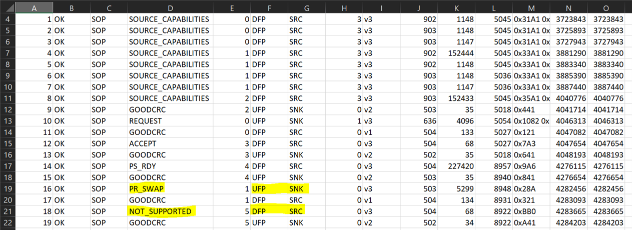

  • I Alex,
    I think I found a test set up that works for my wanted scenario :-)
    I'm using the EVM with SW Projekt TPS65987DDH -> Standard -> DRP, prefers power source.
    In this SW Porjekt I have configured the Port Settings -> I/O Config -> GPIO#21 for Barrel Jack Detect Event.
    This SW Projekt is than flashed onto the EVM.
    As Far-End I'm using a old Samsung A520 mobilephone.
    This is how the PD analyzer trace looks like.
    Standard_Source+GPIO21_BarrelJack_Working.csv
    Line 1: Connection to Far-End side to EVM (without Barrel Jack connected)
    Line 13: Barrel Jack connected to EVM
    Line 57: Barrel Jack disconnected from EVM
    Line 71: Barrel Jack connected to EMV
    So for me it looks good so far. The EVM is switching between SINK and SOURCE as wanted in dependance of the Barrel Jack.
    Please have a look at the trace if you can see any problems.
    Sometimes when connecting the EVM (no Barrel Jack connected) to the Far-End I have the problem that the VBus is switched of after 1 sec.

    When I update the TPS65987D_BarrelJack_event.pjt to be capable of 5V and 9V as in
    TPS65987D_BarrelJack_Event_5V_9V.pjt
    I get an unwanted soft reset after power swap:
    NotWanted_SoftReset.zip
    See lines 25 to 33.
    Why is it like this??
    By the way this also happens with your projekt with higer voltage.
    This behavour is very bad because it means a very long power loss für the system.
    Thanks for your help
    Klaus
  • Hi Klaus,
    The soft reset you highlighted is a soft reset to the cable. All SOP Prime messages are cable PD messages. All SOP messages are regular PD messages. This soft reset is issued by the PD to the cable after the PD swaps to source in order to learn the cable's capabilities (power and data). This does not cause the VBUS drop seen.
    What I am concerned at is the VBUS drop seen after the hard reset (the drop you have circled). This should not be happening, and is not happening in my setup with two EVMs. When you see this VBUS drop issue, are you still testing with an EVM as the far-end device or did you test with something else?
    Alex
  • Yes, for my tests I'm using always two EVM's for my tests.
    The problem is I see very long PR swap times also with your projekts.
    LongPRswapTime.zip
    Only with the projekts
    3225.987DDH_Far_End_EVM.pjt
    7848.TPS65987D_BarrelJack_Event.pjt
    the PR switching times are in both direktions under 100ms.
    In all other porjekts (with higer voltages) the witching times are way above 100ms especialy in the for me important switch wenn the EVM BarrelJack is loosing its BarrelJack power and must be supplyed very fast from the FarEnd side..
    BR Klaus
  • Hi Klaus,
    The long duration is because the swap from source back to sink is not a PR_Swap, but a re-boot and re-connect. When barrel jack power is applied to barrel jack device EVM, the EVM will request a PR_Swap, so the swap will be fast. When barrel jack power is removed from the barrel jack device EVM, the EVM will lose power momentarily, resulting in a reboot and reconnect. This is because the barrel jack detect circuit for the GPIO event is tied to SYS_PWR from the barrel jack receptacle. When system power is lost, and the barrel jack device EVM is in the source role, the PD will reboot.
    If barrel jack detect circuit for the GPIO event is not directly tied to the SYS_PWR from barrel jack, then this can be avoided. The input barrel jack GPIO event must see a falling edge signal before system power is lost. This does not occur on EVM due to hardware design limitations. If the falling edge signal is seen at the configured GPIO before system power is lost, then the PD will request a PR_Swap back to sink, and the issue can be avoided. This is unfortunately not possible to demonstrate without modifying the EVM.
    Alex
