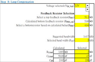

Hi Lin,
You're very welcome. Could you please attach the filled out quickstart calculator, with these values I can help you design and explain the various parts of the circuit.
Thank you and best regards,
Bryan
Hi Lin,
Thanks for the feedback. In Fco you can enter the suggested bandwidth, located right above it.
Then you can use the calculated values for Rcomp/Ccomp/Chf and enter them in the 'selected' column on the right.
This should be a good theoretical starting point for the tuning of your compensation loop. But the actual tuning should be done in the lab, since the component placement and PCB routing influences the actual behavior of the system.
To answer your previous question, the suggested bandwidth is most often calculated in a few possible ways:
Either the switching frequency divided by 10 or another value.
Or the right-half-plane zero divided by 3 or another value.
Or the gain-bandwidth-product of the error amplifier divided by 100 or another value.
I hope this answers your questions.
Bryan

Hi Stefan,
There are recommended bandwidth values in Excel. Do I need to set the values smaller than each other?
In addition, should the value of compensation RC be set smaller than the recommended value?
Finally, could you please tell me how to verify that the bandwidth meets the design value through circuit simulation, and is the compensation RC setting correct?
Hi Lin,
if you study the document I suggested above, you will see that for stability a Phase and Gain Margin should be ensured.
There are some variance on what is recommended but this is also something the user can decide how the environment and what margin he would like to set.
We recommend a phase Margin of > 60 Degree and a gain margin of at least 12dB.
The suggested values are just recommendations. You can adjust them and see the result in the graph on the right side.
To check this, the best is to measure on the real board with a vector network analyzer as this will also capture all the parasitic of the components and the board.
Stefan
