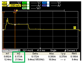

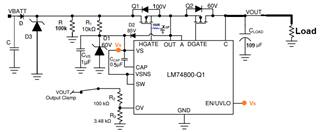

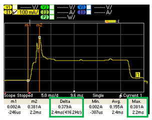

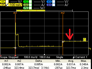

According to my calculation, I limited the inrush current of the MOSFET (Q1) at the input to approximately 0.173A, but I see that it draws 0.381A when the system is first energized. Is this because of the current drawn by the charge pump? Or does this current also pass through the mosfet? What is the reason why it draws 0.381A?
