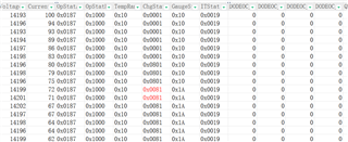

What are the update conditions for DOD_EOC? DOD_EOC is always 0, may I ask because it is not updated or the updated value is too large to display? How do I determine if it is updated?

  • Hello Jose,
    DOD_EOC is also not updated when VCT happens
  • Hello Jose,
    What is the impact if DOD_EOC is not updated?

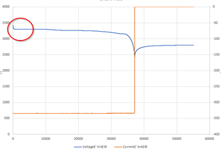

  • Hello Jose,
    GPC-report recommended 400, and I changed the 4103 test。I use LFP battery, ID error is relatively large。

    Warning: First OCVpoint has non-zero current I=  -0.3348 Please make sure you have a 2 hr relaxation period before the beginning of discharge.
    roomtemp_rel_dis_rel_1-1.csv400-R5-2023-11-17.xlsR5-4103-20231116.xlsR5 chushi.gg.csv

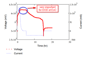

  • Hi Sunrain,
    The input data to the GPCHEM tool does not have a charge to full at the beginning.
    Input data
    You need to submit a charge to full, relax for 2 hours, discharge to empty and relax for 5 hours. This is probably why your matched ID : 400 is not good for End of Charge detection. It was wrongly matched.
    Also, a good matching ID is when the DOD error is below 3%. It looks like the report says that the best ID is 6.55% DOD error deviaton. This is not recommended.
    Note:
    If this error is not decreased when you submit new data, Then you will need to contact your local TI office or contact a Field Apps Engineer (FAE) if you not already have one. Then, the FAE will submit three of your cells for characterization and essentially we will create an ID for your cell. If this is not done properly, then the gauge will not do proper gauging and a lot of error predictions will happen for SOC, SOH, etc.
    Jose Couso
