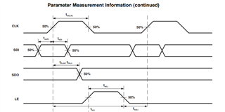

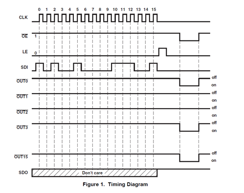

My customer has an question for TLC5925.
From Fugyre 1 in the datasheet(SLVS765B, P9), LE doesn't require CLK signal.
But hold time(th(L)) and setup time (tsu(+)) is specified as 5nsec min in P8 and Figure 5.
Why are the hold and setup time to CLK  specified? What does it mean?
