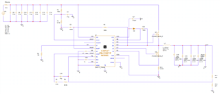

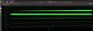

Webench simulation circuit

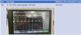

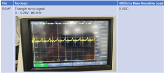

Vout, RT, SS, FB, RES, CM. VCC
RAMP
COMP
HB

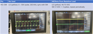

HO - SW

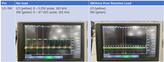

LO - SW
  • Hello Steven
    I think there is a mistake on your layout, or your measurements are wrong.
    V(HB-GND) should be zero voltage when V(VCC-GND) is zero, but it is not when the load is applied.
    -EL
  • Sorry, V_HB is 7V as expected.
  • Hello Steven
    V(HB-GND) should be 0V when V(VCC-GND) is 0V. In your measurement, V(HB-GND) is ~7V while V(VCC-GND) is 0V.

  • Hi Eric, I have updated the schematic. It includes all circuit information now.

    Schematic is updated. Webench simulation circuit is provided as well.

  • Hi Eric.
    I have attached the schematic and layout to this reply. Please note that I did the following things in the layout:
    1. Cut the wire between UVLO and VCCDIS
    2. Use a jumper wire to connect the current sense resistor GND side to PGND.
    I simulated the circuit in PSpice, the simulation result seems to be good.
    Some new findings:
    My Vin=48V, Vout=32V. Although Vout>14.5V (I should use external VCC in the datasheet), I'm using internal VCC = 6V. Could this cause the issue?
    If I use a fixed resistor to replace the I2C digital potentiometer, still the same issue.
    When <=0.2A load, the buck is fine.
    When >0.2A load, buck shuts down and VCC drops to about 2.8V. When load is removed, Vout cannot recover to 32V. I must re-start Vin=48V, then Vout becomes 32V again.
    LM5117_Schematic_Layout.zip

  • Hi Steven,
    Can you re-test SW waveform? From the previous waveform, SW seems to be unstable. I'm not sure if there is some problem with loop design. In addition, there seems to be a lack of connection between the AGNDs of the three LM5117s in the layout. In addition, regarding the layout design, I think the driver problem is relatively big. You can refer to the layout section of Section 9.4 of our LM5148 datasheet for specific design considerations.
    You can also try adding a 5ohm drive resistor to the HS mosfet to see if there is any improvement or connect DEMP to VCC. What's more, considering the piezoelectric effect of ceramic capacitors, the output capacitor can also be increased. Thanks.
