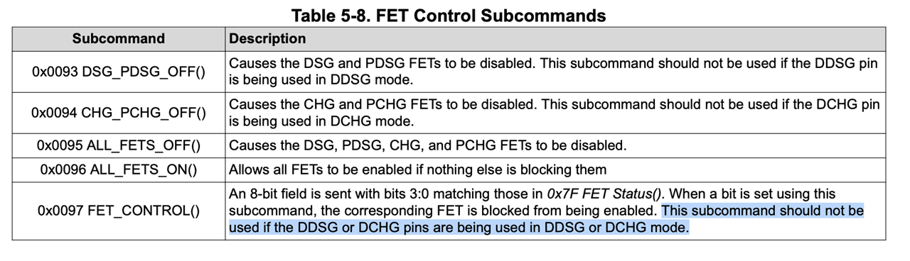

Why does theTechnical Reference Manual say that the FET_CONTROL() subcommands "should not be used if the DDSG or DCHG pins are being used in DDSG or DCHG mode" ?  What are the consequences of using those subcommands when DDSG or DCHG pins are being used in DDSG or DCHG mode?
We'd like to use DDSG and DCHG like FET-specific alert pins, while still controlling the FETs using the FET_CONTROL(), CHG_PCHG_OFF(), and DSG_PDSG_OFF() subcommands. Will this be possible?
From SLUUBY2B: BQ76952 Technical Reference Manual, page 34:
