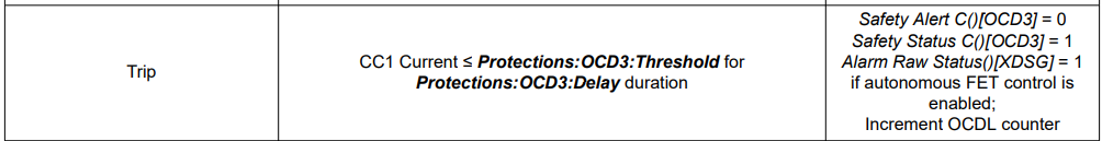

Hello!
When I use OCD3, when I set the threshold of both OCD1 and OCD2 to 0x02, that is, 8A, and OCD3 to 9A, my discharge current is 10A, both OCD1 and OCD2 show faults, but OCD3 does not show faults. At this time, I read that the current value of CC1 is -500mA. The sampling resistance is 0.5 milliohm, the user unit is 10mA, the current of CC1 is less than the OCD3 threshold, so I should observe the OCD3 fault, but I do not see the OCD3 fault at this time, may I ask why this is?
