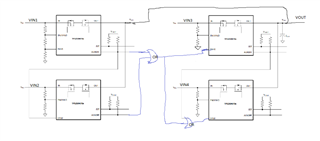

TPS25947: looking for a power mux solution
Part Number: TPS25947
Hi Team,
customer is looking for a power Mux solution for below specs.
    • Must select power from multiple sources (prioritized)
      • USB-C input 1
      • USB-C input 2
      • External battery
      • Internal battery
    • Integrated button controller
    • Voltage 5....10V
    • Current 3...5A (internal battery charging)
our power mux solutions do not support those currents.
Would an efuse solution work here?
How would this be implemented?
