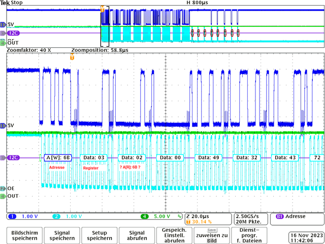

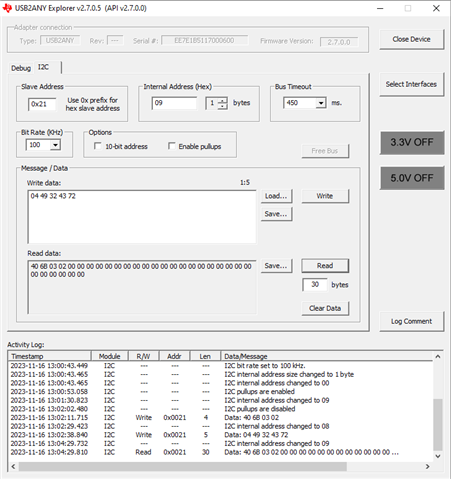

via USB2ANY my customer successfully wrote with I2Cw the TPS25750 which then wrote to BQ25798. They verified this by observing the charging current which increased after writing to register 0x03.

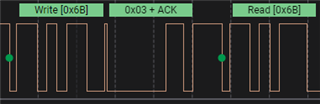

Reading with I2Cr does not work as expected. Below screenshot shows a read of BQ25798 register 0x03, I2C address=0x6B.

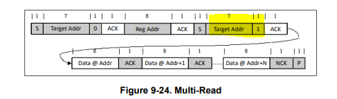

Shouldn't the 3rd byte (from left) show 0x6B? According to BQ25798 data sheet the screen shot should show 6B 02 6B (with read flag)
Here is the whole I2C sequence:
