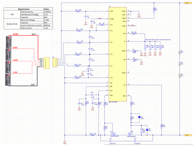

Hi TI team,
Need support on cell balancing circuit values. My max charge current is 2.1A from external charger.
1. Please refer below schematics, I have used  RINI = 1.5K, CINI = 0.1uF. Can i use these values?
2. For ESD protection, instead of capacitor I have used TVS diode (part number : VLIN1616-02G-E3-18).
My pack max voltage is 14.6V. I have used TVS diode with Working value of 16V.
Thank you,
