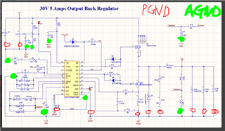

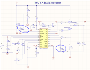

I am working with the LM5117 and i have failed to get the output signal to the FETS.
Below is my circuiit diagram with values computed with the LM5117 Quick calc spreadsheet.
I have measured the following volatges UVLO - 2.5V, RT - 1.2V, SW - 5.3V , VCC - 7.4V, RES, 0V and SS = 0V

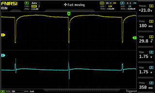

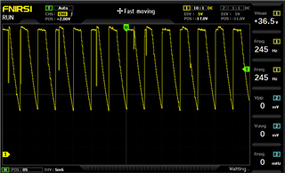

Below are the scope shots showing behaviour at some pins.
HO
LO
RES
SS
  • Hello Nasser
    Please double check the component values and connections in the blue circles.
    100uF is too big. C18 shouldn't be populated.
    -EL
  • Hi Eric,
    Thank you for your response.
    I have double replaced C9 to be 120pF and ignore C18 as its not placed but rather has a bridge of solder to complete line to CSG.

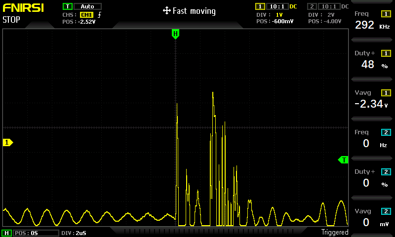

    Below is Wave form at Gate pin of highside FET
  • Hi NK,
    From your waveform, the gate voltage seems lower. So it cannot drive your mosfet. Can you try to change R15 to 0ohm? 120ohm is too large for a drive resistor. Thanks.
    Aurora

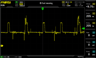

  • Hello AT,

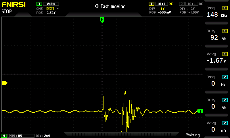

    With 35V in i was able to get 30.6V with out load and the ammeter reads 2mA at the input. Afte loading, I still got 30.6v at 2.54A, the ammeter of teh power suppply was still at 35V but indicating current being drawn as 2.1A.
    This lasted for sometime and later the higside FET smoked. I replaced the FET and still it smoked. Could you share some pointers on where i need to optimise to prevent that, my target is tro draw 5A at 30V.
    highside fet before the smoking happenend and no load.
    After the first smoking and i repalced the FETs
  • The output voltage also drops to 16V too.

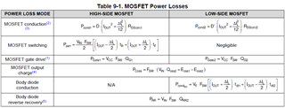

  • Hi NK,
    Can you measure the deadtime between HO and LO single to see if there is any risk of direct access? In addition, the current choice of LS mosfet is not suitable. The reverse recovery loss generated by the LS mosfet is too large, and this part of the loss will fall on the HS mosfet. You may consider replacing the LS mosfet with an Rdson of around 20~30mohm. You can also connect a Schottky diode in reverse parallel to the LS mosfet to see if it helps. You can refer to below table to check the power losses. Thanks.
    Aurora

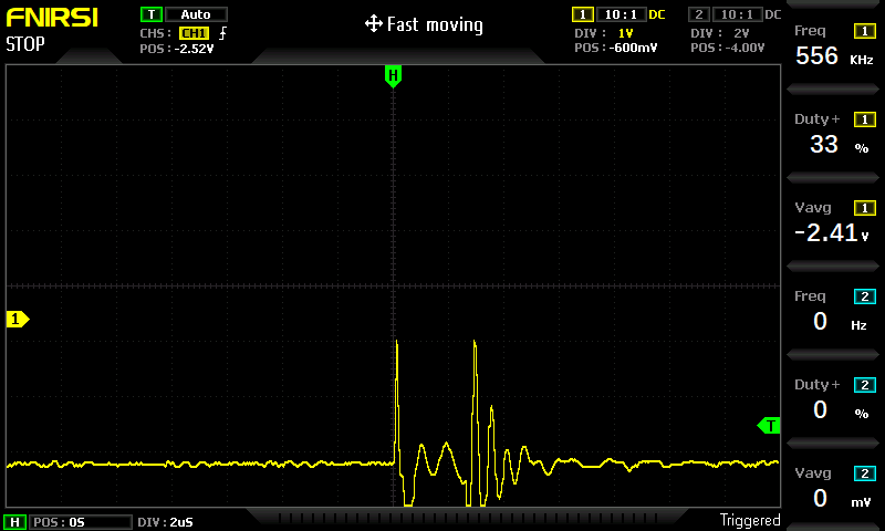

  • Hi AT,
    On zooming on the scope images, I can see there is risk for current shoot through. The LS starts to raise to on state 25nS before the HS starts to go low. before connecting the load.
    Please could you recommend a LS that i can pair up with the current HS. I am thinking about using  N Channel FET  220N06L3, do you think its good subsititute. Kinldy guide on the connection of the schottky diode on LS measured.
    Thank you.

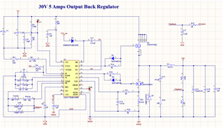

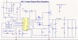

    I have made teh decisoin to actually redo anothe PCB , this time round paying keen attention to comeponet selection and the PCB schematics. Having had a challenge with the FET selection on the previous version i have choosen to go in with the actual ones used in the TI evaluation board.
    I have attached here my new schematics for you to review and guide me while I also work on teh PCB and will also sahre it immediately before I send it for fabrication.
    I will be most humbled for your review on this.
    Icomputed Values for BuckCOnverter.pdf
  • Hello Nasser
    Please refer my comments below.
    • 150W power supply requires a thermally optimized PCB design to handle the power dissipation.
    • If hard saturation core, the saturation current of the inductor should be greater than 12.1A
    • >~25V minimum start-up voltage is enough for the 35V minimum input voltage.
    • Typically high-RDSON low-Qg MOSFET is used on the high-side, and low-RDSON high-Qg MOSFET is used on the low-side.
    • It is recommended to separate analog ground from power ground on the schematic.
    • C3 value is too high.
    • D4 direction is wrong.
    • Use ~1uF at C4
    • Use ~1uF at C9
    • Adjust loop compensation and make the crossover frequency < ~4kHz
    -EL
  • HI Eric,
    I have revised the schematics  as in your last response. Notably is my choice of FETS that i wouldlike you to evaluate, they both a TI FET's , CSD19538Q2 on the higside and CSD19505KTT on the low side.
    I have attached a brief spec sheet of the choice of this is the inductor i will use.
    I have adjusted the loop compesation to ~1KHZ.
    I will await your response to kick off on the PCB.
    5466.Buck Converter.pdf
  • Hello Nasser
    Please refer my additional comments below.
    • Separate AGND and PGND on the schematic level, and tie them via a net-tie
    • D2 is unnecessary
    • Use >50V diode at D1
    • Can you select >50V FET in order to make Qg x Rds smaller ? I think you can find a smaller Rdson MOSFET on the high side.
    -EL
  • Thank Eric, Please calrrify on your last statement. I should find a smaller RdsOn Mosfet on the high side, could you tell me what range in mΩ . Also for >50V FET, are you meaning Vds for Highside.  Thank you.
  • Hello Nasser
    The smaller Rdson is the better always.
    Yes, you selected 100V MOSFET while the maximum VIN is only 30V. In general, 50V is enough for 30V application.
    -EL
  • Thank you Eric, I got you there. I have updated the schematics as dsicussed, i have selected CSD18536KCS on the low side and Replaced teh boot diode with PMEG60T20ELXDX.
    I have not yet connected AGND with PGND , I am curious what I have to consider while making this link, whats your thought on that. Lastly, for the PCB layout shared, the component placing and how i have tried to disspate the heat for the HS with vias to the bottom plane of that net.  is it not risky to disspate heat that heat into the PCB its'self ?
    Thank you.
  • Hello Nasser
    • Please confirm the maximum input voltage.
    • Please connect AGND and PGND at the DAP/EP.
    • Yes, there is a risk. If you can, please consider heat-sink on both sides.
    -EL
