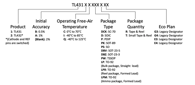

For the TO-92 (LP) package the TI drawing shows two options, straight leads and bent leads. If these fall under the same orderable part number how do I know which type of leads are correct and which type of leads I will be receiving?
Example orderable number is TL431CLPR
