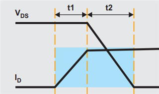

  • Dao,
    HO sources highside FET and controls SW turning on. HOL sinks high-side FET and controls SW turning off.
    Rise and fall times will be similar if HO and HOL are connected to the FET, or use the same gate resistor.
    If you have different gate resistors for HO and HOL then the rise and fall time will be different.
    Yes, VIN is VDS(off) of MOSFET.
    Note that buck "switching losses" are result of overlaping current and voltage.
    Please reference https://www.ti.com/lit/an/slyt664/slyt664.pdf and figure 5 blue area.
    The high-side MOSFET has to overlap all of VDS / VIN and switching current.
    The low-side MOSFET does not overlap all of VDS with switching current. Low-side MOSFET only overlaps low-side body diode voltage ~0.7V with switching current, so the switching losses are much lower compared to high-side.
