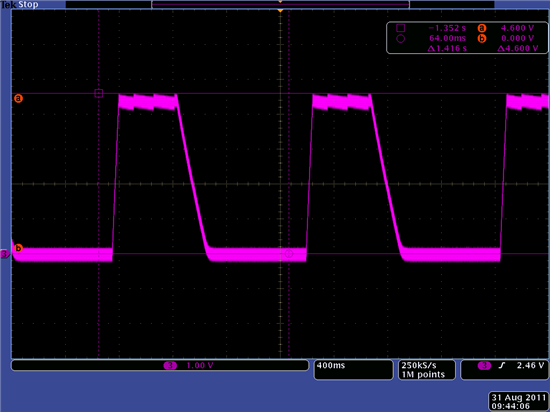

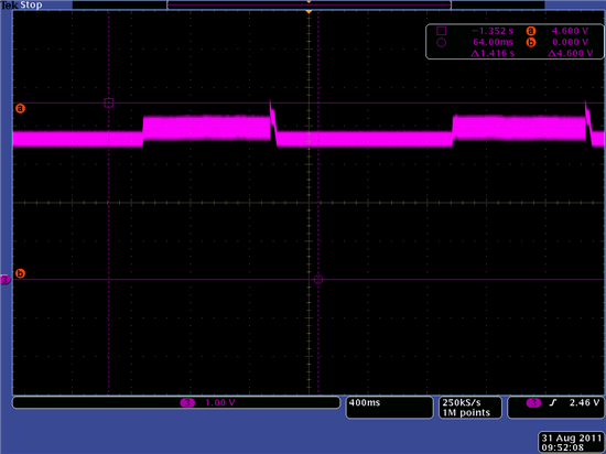

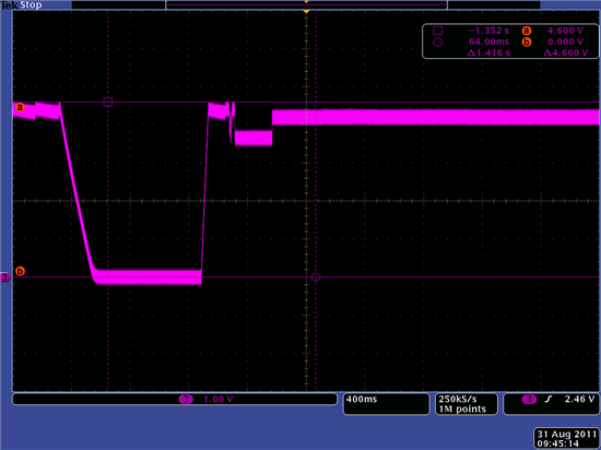

    Please have a look at the three graphs.
    - NoBat.png:  Voltage at BAT pin without any battery connected.
    - Cable Connecting.png:  A battery is connected through cables --> the charging station charges the battery.
    - Normal Contacts.png: The battery is connected through the normal contacts (just inserted to the charging station). The charging station always starts and stops charging.

  • Rony,
    These shots are from the BAT pin on the IC?
    Can you send me shots from the OUT pin in the same time frame?
    have you measured the actual contact resistance of the connector? This actually could be the issue.  Let me know what you find.
    Richard Elmquist

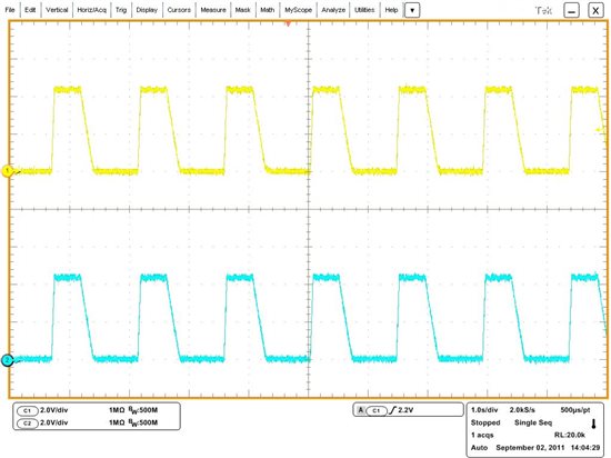

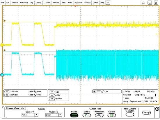

  • Richard,
    The shots are from the BAT pin. Below, you find the same shots from the BAT pin ( yellow) and the OUT pin (blue).
    The contact resistance is about 1 ohm.

  • your battery connection resistance is too high.  It should be in the 10s of milliohms.
  • If I connect the batteries with cables to the charging station (battery -> cable -> charging station contact) the resistance is also about 1 ohm and then it works.
    However, I guess that the connect between battery and charging station (without cable) is not constant and sometimes is quite more than 1ohm... Would that be an explanation?
    Is there anything I can do except for changing the contact system of the charging station?
    Rony
  • That could be it or you may have more inductance in the line that has the issue.  More capacitance at the output of the charger would help cancel the inductance.
