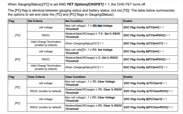

Hi Team..
1. When GaugingStatus()[TC] is set AND FET Options[CHGFET] = 1, the CHG FET turns off.
2. Is it possible for the chg fet to recover to turn on when a cell voltage drop to some level
3. Is any option for this issue?
