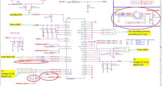

    Can you provide your schematic
    Sure. I paste a schematic screenshot of only the PD part below. I will also send the complete file by e-mail.

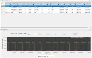

    We tried to get Total Phase's PD analyzer but unfortunately this product has been EOL. We tried to use other product with similar functions (Cypress CY4500) to capture the PD log of our board connected to the BC1.2 charger. As shown in the picture below, we got 3 HARD_RESET SOPs after connecting to the BC1.2 charger.
    In addition, we want to mention that after connecting to the BC1.2 charger, we tried to use the I2Cr command of TPS25750 to read the value from some registers of BQ25713, but it was no longer possible to read it. Unless we restart the TPS25750 (through the 4CC command 'GAID'), we can use I2Cr / I2Cw to read and write BQ25713 again. We assume whether the BC1.2 charger caused the BQ25713 hanging.
    Anyway, we hope this information helps you diagnose our issue. If you need anything else, please feel free to tell us.

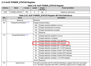

    We would like to mention another discovery. We have confirmed that the USB_P and USB_N pins are correctly connected to the GPIO4 and GPIO5 of the TPS25750 respectively. When we connected the BC1.2 adapter to our board, we did not see any detection signals on the scope.
    No matter what kind of charger we plug in (CDP, DCP), when we read the 0x3F register of TPS25750, we always get the result of detection as SDP.
    We don't know if this finding is related to the not working with BQ charger we mentioned. Not sure if this is normal? Or could this also be a serious problem?
