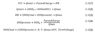

From the information, the FCC's updated formula is as follows:
1. Passedcharge is the cumulative capacity of the current charging or discharging. If 5% is discharged, immediately charge 5%. At this point, the PassedCharge is 10%?
