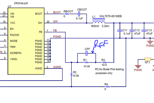

Could you help check below the TPS548A28 & TPS56637 schematic and any need to adjust ,Thanks

Hi Gareth,
Looking at the TPS548A28 designs,
U59:
1. Use higher rated input capacitors for C598/C600/C601, which is currently 6.3 V which is not suitable for 12 Vin.
2. This device is connected for 600 kHz FCCM if that is correct.
3. The FB network currently has an output of 5.1 Vout if intended, otherwise would recommend decreasing it to the targeted 5 V.
4. The device requires a CFF of 139 pF with recommended RFF of 3.75 kΩ.
5. Recommend decreasing Rtrip to 4.22 kΩ to have a higher current limit.
U67:
1. Use higher rated input capacitors for C658/C659/C661, which is currently 6.3 V which is not suitable for 12 Vin.
2. This device is connected for 800 kHz FCCM if that is correct.
3. The device requires a CFF of 111 pF with a recommended RFF of 2.27 kΩ.
4. Recommend decreasing Rtrip to 3.92 kΩ to have a higher current limit.
