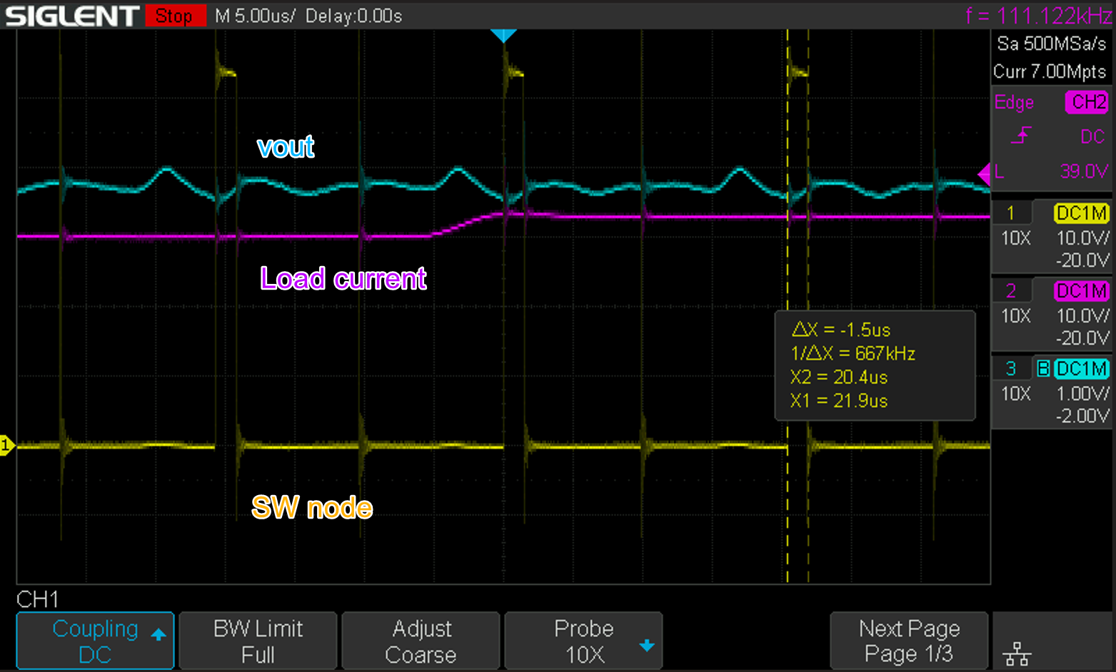

I am having a problem using the LM5143A-Q1 in interleaved mode where the SW node is pulse skipping every other pulse. My converter operates at 100kHz, but the SW node only switches at 50kHz. Because half the pulses are being missed, the duty cycle on time is double what it should be. This is causing a false overcurrent trip condition. Why would the converter be skipping every other SW node pulse? Incorrect compensation component values? Incorrect inductor DCR current sense values? Incorrect output capacitor ESR? I'm not sure what knobs to adjust to get my regulator to work.
Below is my schematic for this design.
Design criteria:
Vin = 20-56V
Vout = 3.8V
Fsw = 100kHz
Iout max = 50A
Below is a screenshot. Notice the SW node is on for double it's expected on time (should be on for ~0.7us and it's on for ~1.4us). The SW pulses do happen every 100kHz, but only the ones that happen at 50kHz have a useful duty cycle (half of them are only on for ~50ns, which is barely anything).

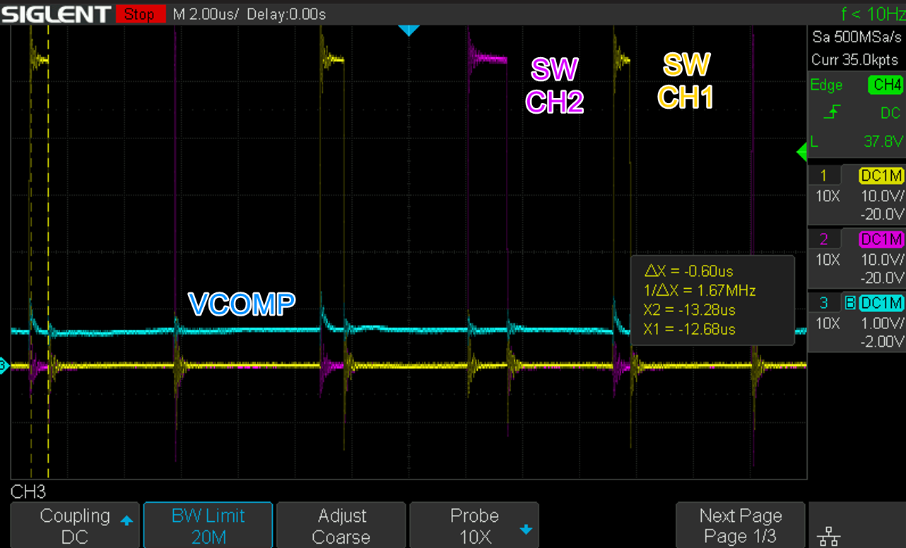

  • Brandon,
    Do you have this at no-load? Or just a resistive load?
    Also can you show SW1 and SW2?
    Also a separate plot with VCOMP will be useful.
    Thank you,
    -Orlando
  • Orlando,
    I am using an electronic load, so purely resistive.
    Below is an oscope image of SW1, SW2 and VCOMP. A few interesting notes for you:
    When R4 and R12 are 15k, the SW node looks normal, but the overcurrent still trips earlier than 50A. Below is the image. In this case, the load current shown in green is about 38A. I believe the SW node noise is coupling into VCOMP, so I don't think the noise is real.
    When R4 and R12 are 30k, the SW node does not look normal. Below is an image at 30A load. The overcurrent protection hasn't tripped, but SW CH2 is skipping every other pulse and SW CH1 looks normal.
    Below is the same setup as below, but the overcurrent trips when the load is increased. It looks like both SW CH1 and CH2 are skipping pulses.
    Lastly, below is the VCOMP net on it's own near the trip point using the 30k resistor values.
    Do you know why the SW node would skip for one channel and not the other? Why would changing those resistor values impact the pulse skipping?
