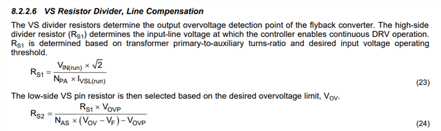

  • Hi Eric,
    What you need to do is to change both R1 and R2 (voltage divider resistors at Vs). As I mentioned above, if you changed R1 to 10K, now R2 needs to be reduced with the same factor than R1 was reduced from original value from EVM. Check section 8.2.2.6 from Datasheet where you can find the equations that define both values (see below).

  • Hi Manuel.
    After replacing a new microelectronic controller, I recalculated according to the two formulas you provided.
    Since our minimum input voltage is 24Vdc, I calculated that RS1 is 27kohm and RS2 is 7kohm. After replacing the resistors based on my calculations, I tested the voltage on Vdd and found it to be in Fault Protection mode.
    What should I do to ensure it operates normally at 24Vdc?
    Thank you.
  • Hi Eric,
    -If the minimum input voltage changes (decreases), the design of the converter changes as well. The EVM is designed for a minimum Vin of 85Vac/120Vdc. The decrement from 120Vdc to 24Vdc is considerable and therefore, the design of the transformer (Lm, Nps), bulk capacitor (Cbulk), Rs1, Rs2 (already discussed) will change as well.
    -I recommend to re-design your schematic using the spreadsheet design calculator tool available in UCC28740 product folder (click on the link below). In this calculator design tool you need to input your input, output and switching specifications (see picture below). What you can do is to use the same parameters specified in the EVM (if it is the case that your design is bases on it) and change the minimum input voltage. These values are reflected in the picture below. Let me know if you have any questions.

    We recalculated and found that we made a mistake in the value of VF in the formula. So, we replaced the resistor values of R2 and R3 on the diagram. The new value for R2 is 82 kohms, and the value for R3 is 36.5 kohms. The circuit successfully operated when the input voltage was 24Vdc. We then attempted to increase the input voltage because we need the circuit to operate at 230Vac. Until 219Vac, the circuit functioned well. However, at 219Vac, we observed that the output voltage dropped from 5V to 0V suddenly. We suspect that the UCC28740 may be damaged, so we tested the voltage on pin Vdd and obtained the following results:
    It seems unusual for an issue to occur on Vdd. However, the fact that R2/(R2+R3) near pin VS is testing at 0.3, similar to the value on the EVM, indicates that there might be a problem elsewhere. Do you have any insights into the specific location of the problem?
    Thank you.
  • Additionally, we did not change two resistors of pin CS during testing. However, later, based on the datasheet formula, we calculated that RCS is 0.214 ohms, and RLC is 429.2 ohms. These values are smaller than the resistances on the EVM. Could you please confirm if these two values are feasible?
    Thank you
  • Hi Eric,
    -If R2=82Kohms and R3=36.5Kohms, the new overvoltage factor R3/(R2+R3)=0.3. This value is greater than the original factor from EVM ( R3/(R2+R3)=0.2). This might lead to an OVP at high Vinac. If the IC is starting correctly at Vdc=24V, R2 design is correct. Calculating your R3 value according to you values and considering OVP=5.20V. R3=49Kohms. Please try with this new value.
    -About, Rcs and Rlc. This values depend on Nps, Nps and Lp. If you changed these values from EVM, I recommend updating those values in your new schematic.
