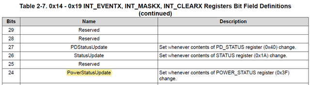

My customer has a critical issue regarding PowerStatusUpdate as below.
POWER_STATUS register (0x3F) doesn't change but  the state of PowerStatusUpdate become "1".
Additional case is "0" is written to PowerStatusUpdate with INT_CLEAR, and immediately after that, PowerStatusUpdate may become "1" again. (POWER_STATUS register (0x3F) has not changed.)
Is it possible for something like the above to happen?
I believe that PowerStatusUpdate clearly indicates that the POWER_STATUS register (0x3F) has changed, but is there anything other than POWER_STATUS register (0x3F) that is affected?

     The charger advertisement/detection and the other all field in POWER_STATUS register (0x3F) hadn't be changed.
    Is my understanding correct that PowerStatusUpdate triggers "1" if one of any status in POWER_STATUS register (0x3F) changes?
    If YES, do you think the events we have confirmed are abnormal?

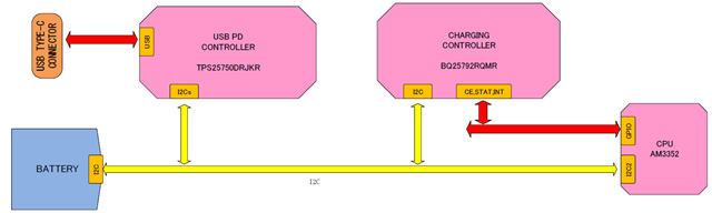

    We confirmed to our customer that ChargeAdvertiseStatus and ChargeDetectStatus register doesn't change.
    In their system, TPS25750 and BQ25792 do not communicate directly via I2C. Therefore, the charger status of TPS25750 is not rewritten.
    The read log of the PowerStatusUpdate register is shown below.
