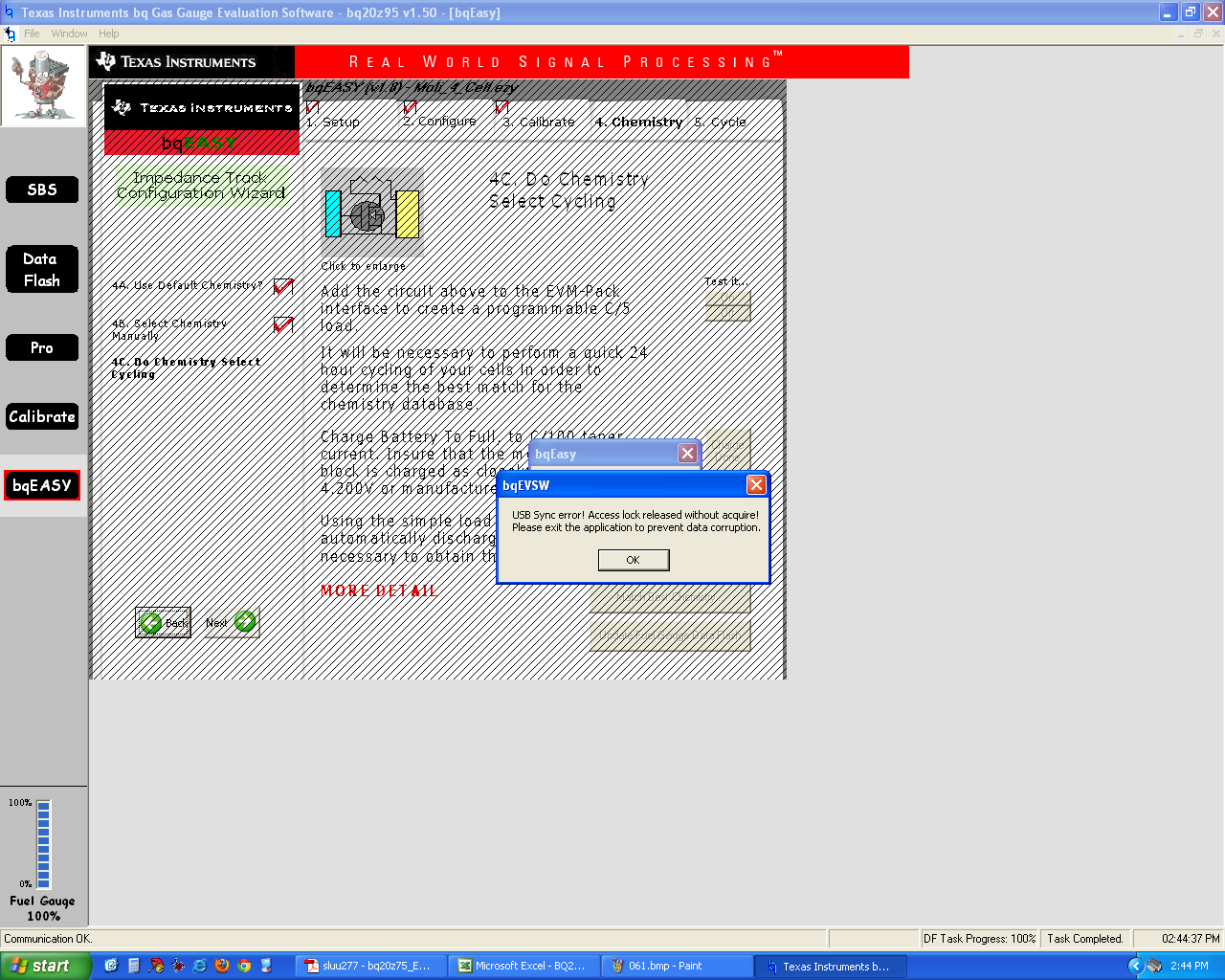

    I use the tools "bqeasy" to identify the cell's chemistry ID. At the step of "match the best chemistry", the windows pops out "Syn error"...I have done twice and met with the same error. Who can help me?
The bqeasy softeware version: 0.9.59.
gas gauge IC:bq20z75 v160
Best regards.

  • I am having the same problem.  Here are the screen shots at the end of the chem id cycle..
    1.  Discharge cycle almost complete
    2. sync error
    3. vb code error
    4. me slashing my wrists because it will take two days to run through the chem id cycle again
    Maybe someone knows how to use the chem.log file to pick a close match for the chem id.  If someone can and does, thank you.
    A frustrated Peter
    3806.bqEasy_Sync_Error_Screens.zip
    0160.Chem.log
  • Jackie, or anyone:
    I too am having the same problem as the original post (and others on different threads on this forum).  As you requested, I am attaching the screen shots of the error codes.  I am runing bqEasy ver. 9.75 on a pc with xp pro and all the latest drivers for the EV2300.  I am using the TI eval board, HPA246 rev B which is the bq20z95EVM board.  The battery config is 4 li Ion cells in series.  The cell datasheet is attached to other posts I have made to the forum.  I have tried this three times now and have been getting the same failure.  As others have been getting this error, too - I am thinking there could be some rare pc hw/processor issue that has not been noticed (nor corrected) by TI yet.  Could someone at TI please take a moment to match the chem.log to a chem id for us so we can move on to the next phase (golden pack cycling).  Our demo date is quickly approaching and someone's help would be much appreciated. Also, let us know if there is something wacky with the chem.log file as this could be a clue to us.

  • Hi, Peter
         Using the battery pack to indentify the CHEMISTRY_ID is still a headache to me. Here is some advise from TI:
     1) Use the single fresh cell to do the chemistry ID
          Use the mathcad tool which can be downloaded from TI WEB SIT to do it . It can find a similar chemistry id or closest to  your application.   http://www.ti.com/lit/sw/sluc138t/sluc138t.zip
     2) Send the fresh cell sample to your local TI Office
          They can help us to get a cloest or newer chemistry id for us. If your cell specification is not listed in the chemistry id table, just send the cell directly..
      I use the first choice.
