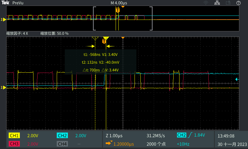

I get this waveform:
CH1 (yellow waveform) : indicates the output waveform of the DPWMA
CH2 (blue waveform) : Indicates the voltage sampled by comparator D
CH3 (red waveform) : indicates the output waveform of the DPWMB
Different trigger points have different effects on the waveform,I have a question about these waveforms:
If the falling edge of DPWMA is used as the trigger point, the DPWM wave will be lowered after 3 triggers at most, but I set 4 consecutive triggers in the Settings to lower the DPWM wave,so the trigger point for CBC is at which specific moment?

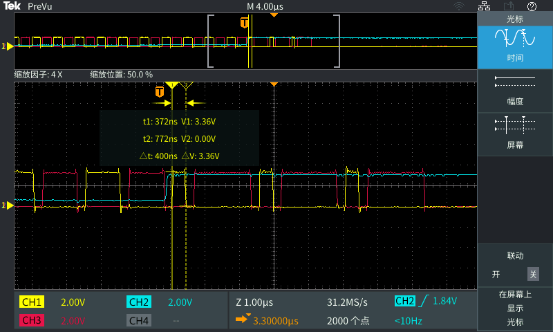

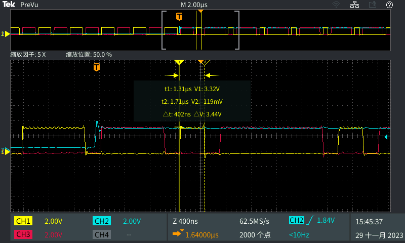

When I changed the mode to Multi mode, I set the start and end of blanking time B to 100, the start and end of blanking time A to 125, and set the duty cycle of DPWMA and DPWMB to match each other when triggered by CBC. When I set the trigger point to DPWMA and DPWMB under two different conditions, the following waveform was obtained:
When the trigger point is in DPWMA, the subsequent output waveform is output according to the minimum duty cycle of DPWMA, that is, the value from the beginning to the end of the blanking register A; but when the trigger point is in DPWMB, the subsequent output waveform is not controlled by the start to the end of the blanking register B.

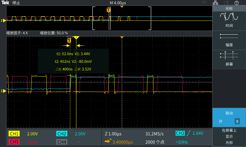

  • I have solved the second problem. Because the time set from the start to the end of the blanking register B is too short, the minimum duty cycle of DPWMB is almost no. When I set the time set from the start to the end of the blanking register B to be greater than the rising edge time of DPWMB, It can be found that the minimum duty cycle of DPWMB is equal to the time from the start to the end of the blanking register B minus the DPWMB rising edge time.

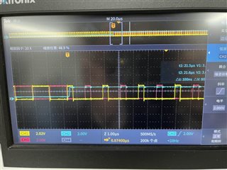

  • The top five images are wrong. This is the updated image:
