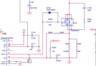

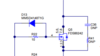

We make our design, as per PMP11254 referance design. What is a role of below D13 diode in Gate drive.
Our device is Air tight so heating of POE section, PCB is heating very much high.
Please help me regarding above issue.

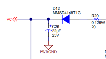

What is happen when swap D12 and R20 position in circuit. Because in datasheet diode and resistor position swap in typical circuit.
I have do in my board on Monday. board working fine till now.

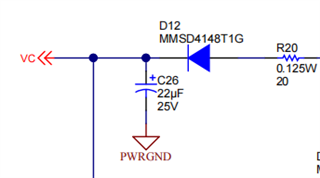

Please give us your suggestion for below circuit.
Please give me above two comment answer.

1. D13 ensure a fast switching off speed for Q5. This can help to reduce the switching off energy. If you have a secondary side sync FET, this also help to reduce the pri-sec FETs shoot-though time.
2.There should be no issue to swap D12 and R20 position.

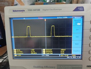

Hi Diang,

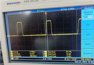

Please find waveform of GATE-RTN Voltage as below,

Hi Pallav,
Thanks for the gate voltage waveforms. The duty cycle (D) is about 17%. And the turns ratio is 2:1.
By N*Vout = D/(1-D) * Vin, Vin is ~117V, which is higher than the 54V-POE input. Looks like the gate duty cycle could be varying at the same load current or the load is too light. Could you help to check:
- a zoom-out gate waveforms to see if the duty cycle is keeping at ~17% or it is variable at the same load current
- if the Vout could be stable when you have a heavier load.
Diang
Hi Diang,
I have attached photo for Gate waveform when load as only our device, vary duty cycle 12% - 16%
I have attached photo for Gate waveform when load as only our device + Lock, vary duty cycle 17% - 18%.

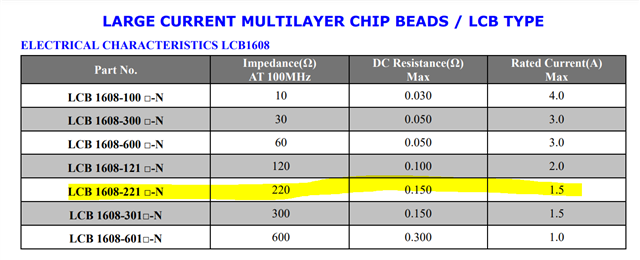

We are using LCB1608-221Y-N for L14. Please find attachment datasheet. Let me know, Is it ok or not?
Hi Pallav,
LCB1608-221Y-N is rated for 1.5A. I am wondering what is your output power at 12-V. Looks like P needs to be smaller than 18W.
Using 2*pi*100e6*L=220, L is ~0.35 uH at 100MHz. You can try to further increase the inductance to 2.2 - 4.7 uH which may help to flat the current and the voltage ripples.
