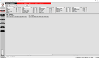

I am having problems communicating with a bq27350 device. I have installed the relevant bqEVSWSetup00.09.59_bq27350v1.00 software and when I run the BQ evaluation software there is no data showing in the register fields. even with the tick box for "keep scanning" active, no information is presented. I am using an EV2400 to interface with the chip and I know the peripherals are all good

  • Hi Jonny
    No, i had no error appear when connecting to the bq27350.
    I have used other devices like the bq20z65 and bq40z65 on the same setup and they worked fine.
    I have attached an image showing what i get with the bq27350. Note, it keeps scanning and no data appears. the other commands in Data Flash and I2C Pro do nothing as well. It feels like the EV2400 does detect the device because normally if there is no device present it comes up with an option to which device you want to talk to. In this case it doesnt come up and recognises the bq27350 but no data

    One thing I have noticed is that at the bottom it says No Acknowledge: VB_T2H_NACK, is this a hint to whats going on?
    Scott

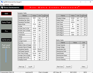

  • Jonny, i Just tried something else and its confirming alot of things. By accident i opened up the b2084 tool which i use for other gauges as its SMbus protocol.
    This time the device has been detected as before, but is now throwing a lot of data around. I expect that this data is the device returning register addresses that were meant for SMbus but as its an I2C device its returning nonsense. So this proves that the Device is Ok, and the setup is OK. There's something wrong with the bq27350 tool that's meant to be pulling the info.
    image of the bq27350 on the bq2084

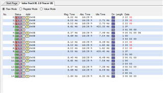

  • Jonny,
    Here is a snap shot of the analyser data.
    I also did an experiment with the bq2084 too and this is the data on the analyser using that tool.
    As I expected, the bq2084 is seemingly communicating ok, it just decodes the data differently.
    The other gauge tool doesnt though
