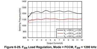

According to the datasheet, it is mentioned that, under the same conditions,
the switching frequency increases as the output voltage(Vout) decreases for a same input voltage(Vin).
As I know, by this equation, fsw ≤ 1/t_on ×(Vout/Vin)
when the output voltage decreases, then the switching frequency also decreases.
I was wondering if I can get explanation for this?
Does the value of t_on change according to the Vout voltage?

  • Thank you for reply,
    Could you also answer the question at the top?
  • The on-time is internally generated by a time constant and definitely there is some tolerance to that time constant. Also, the off-time also varies depending on the input/output conditions as it is dependent on Vout, Iout, DCR, LSFET Rdson variations and also inductor ripple. So this can lead to slight variations in the time period and hence the frequency. For a given Vin and Vout, the frequency variation is minimal so this should not be a big concern. Please let me know if there are any more questions.
