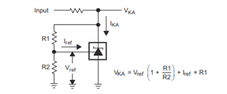

TL431: Output Oscillation Query
Part Number: TL431
In TL431, While testing, Oscillations are observed  at output while operating it as simple shunt regulator. We changed the feedback resistance value to higher(i.e. 30k ) than previous(Two 10k's), Oscillations are not observed(i.e. stable output)  with 30k feedback resistors. How the oscillations are controlled by feedback resistors ? I couldn't see any thing from data sheet about the same. I only knew the load capacitance requirement to meet the stability which we strictly maintained.
Sandeep.
