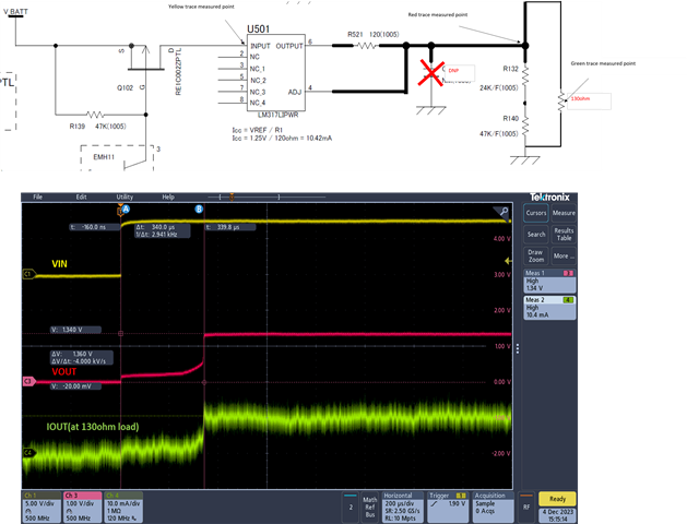

They are considering using it in the constant current circuit of the LM317.

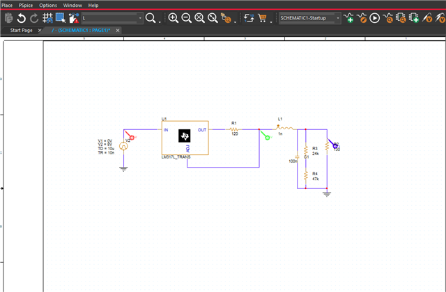

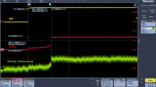

The current and voltage waveforms at startup were measured in the test circuit.
We also performed simulations using PSPICE for TI.
Since the results were significantly different from the actually measured waveforms, we have received inquiries regarding the reason.
Could you please give me some advice on the different reasons?
There is also a large discrepancy between simulation and actual measurement results regarding startup time.
Simulation: 60us(Green trace)
Actual:340us(Red trace)
I would like to know the approximate time it takes for the Vout voltage to rise.
Do you know how long it will take?
