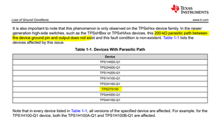

    It appears you are triggering a double fault scenario where there is a loss of ground and a low impedance short from VS to board ground
    Do note, there is a known parasitic path in the device further detailed in this app note:
    https://www.ti.com/lit/an/slvaes9a/slvaes9a.pdf?ts=1701985514360&ref_url=https%253A%252F%252Fwww.google.com%252F
    If this double fault scenario is something you expect to see, you will have to switch up your ground network to something similar to below:

    For 200-kΩ internal parasitic path that you are talking, from the ground pin to the output pin, as specified at this table:

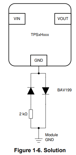

    3. Have you tested the proposed BAV199 solution?
    If you are seeing 24V at Vin1 and 240mA under a 100ohm load, then my suspicion is there is an external parasitic path from ground to VIN which is causing the gate to charge and the FET to conduct as noted in the provided app note.
    If so, my recommendation would be to use the BAV199 solution as shown below in order to create a 1V difference between the supply voltage seen at the input and device ground further described in https://www.ti.com/lit/an/slvaes9a/slvaes9a.pdf?ts=1701985514360&ref_url=https%253A%252F%252Fwww.google.com%252F
    Do note, if a GND network is used, a input diode is not needed. Is there a reason an input diode is included along with a ground network in your design?

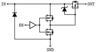

    In my opinion, the problem could be due to the gate driver of the output MOS. Let's hypothesize an internal structure similar to the following:
    The current finds its path through the body diode of the low-side MOS in the driver, charging the output MOS gate-source capacitance beyond the threshold voltage. Therefore, the output MOS gets activated and can conduct current coming from the protection diode at IN-GND.
    In fact, there is about 0.7 V diode drop between GND and IN.
    The only option I see to retain both inductive load protection and reverse polarity protection is to remove the resistor in the ground network and use a TVS to suppress the inductive voltage spike at the output.
    Can you please confirm this is true?

    It is pretty much clear that the equivalent circuit during the fault condition is similar to the following, assuming a simple gate driver without protections:
    In this case, neglecting the on resistance of the MOSFET (which is probably not fully turned on), the calculated current on the output is
    I = (24 V – 0.7 V) / (2.2 kΩ + 100 Ω) = 10.1 mA
    which accurately predicts what I measure, as I highlighted in my first post.

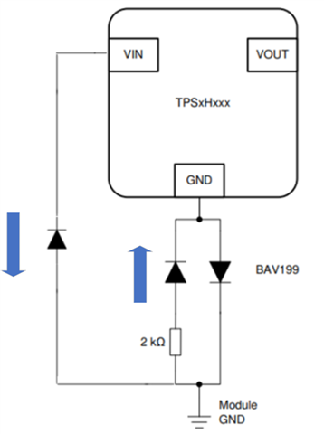

    I did some brainstorming and have an idea for us to try!
    Essentially our root issue is when the GND of the device and the supply of the device are between 0.5V and 1V difference there is potential for unintended turn on of the FET. This can arise two ways:
    • When VIN is floating, the internal ESD diode provides the path of least resistance to power VIN through the GND pin which forces VIN and GND to be within the 0.5-1V range.
    • When VIN is not floating, the 200kohm resistive path described in the app note I provided creates the path to force GND within a 0.5-1V range of the supply VIN
    A potential fix to ensure VIN is not floating is to shunt the supply to module GND by way of a diode. A good option would be a TVS or Schottky diode. A TVS diode would have the additional benefit of transient suppression in the case of a input voltage surge.
    The BAV199 solution would still be needed to ensure the VIN to GND difference is greater than 1V during this condition.

  • Hi Elizabeth,
    thank you very much for your response and sorry for the delay.
    I tried your solution by bodge-wiring components in my existing design, and it seems to work.
    However, I prefer to do further checks before confirming the answer. Currently I'm waiting for additional components from a distributor to do some more tests; I'll let you know the results as soon as possible.
    Thank you again for your patience.
    Federico

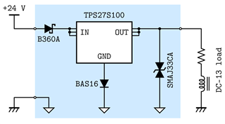

  • Hi Elizabeth,
    I discussed with my manager the results obtained with your solution. It surely helps keeping the MOS in a nearly-off state (better than before), but sadly it is not enough for our application; in fact, the equivalent channel resistance we estimated in the fault condition is about 120 kΩ.
    If a customer connects the product to a high impedance interface, they might see a high logic level depending on their application and this is not acceptable.
    Instead, I propose a different solution which I'm testing by driving a DC-13 load (by standard IEC 60947-5):
    Our product is highlighted in blue, connections done by the customer are external. With this solution:
    1. the product is protected by a TVS diode in the case of heavy inductive loads causing voltage spikes;
    2. the product does not power on if +24 V is applied to the output, thanks to the Schottky diode at the input;
    3. the TPS27S100 does not partially conduct from GND to OUT if +24 V is applied at the product's ground, thanks to the BAS16 diode (w/o other components in the GND network).
    So far, I did approximately 200,000 successful cycles with the DC-13 load (at 580 mA peak current). Moreover, now points 2 and 3 check out. I'm planning to do at least 1 million DC-13 cycles and then double the peak current, to test whether the TPS27S100 is protected enough by the TVS diode, and I will let you know the results when tests complete.
    The only drawback is the size of the TVS diode I had to choose in order to guarantee our output specifications.
    Is it possible for you to check if my solution has some downside I am missing, please?
    Thank you!
    Federico

    Instead I would recommend beefing up the original solution.
    Ultimately, we want 0.5 < |VIN-GND| < 1V so to make the previous solution below more robust against a high impedance load, we would increase the ground diode's forward voltage and/or decrease the Vin diode's forward voltage.
    When you say the proposed solution did not work enough, could you elaborate? In the situation where high impedance interface was connected, and a high logic level was read, what was the voltage on VIN and GND_IC?
    A quick check on this proposed improvement could be adding two series diodes in series with 2kohms to see the improvement in results.

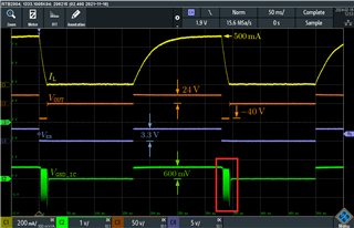

    I would like to insist a bit more on my solution with an output TVS, since I did not succeed in finding what you describe here:
    Unfortunately, without a resistor in parallel with the ground diode, there could be damage to the IO pins during inductive discharge.
    This is because during inductive discharge the output becomes very negative. This will pull the IC_GND to the same negative potential. In this case, control signals will reference device GND. For example if Vout saw -30V, a 5V signal to EN would be read by the device as 35V.
    In fact, no damage affects the TPS27S100, and I reached around 1.8×106 activations with a DC-13 load.
    For the sake of clarity, this is a more complete schematic of my application including the microcontroller:
    I find that voltage on the IC ground does not go as low as the output; instead, it seems to be clamped at -1 V. Since this condition happens while EN is low, it does not exceed +1 V referring to the IC ground.
    I hypothesized the 47 kΩ pull-down on the EN pin to divide voltage with the internal 500 kΩ pull-down and other parasitics, but removing the 47 kΩ has no effect on the waveforms and no damage occurs without it.
    Is this explainable in your opinion? I do not see evident problems from my test results.
    Moreover, I see a steady oscillation on the IC ground (therefore on EN referenced to IC ground). Is this the charge pump oscillator floating during discharge, or some form of protection?
    It can be seen also without TVS on the output. It does not cause any problem to me but I would like to identify and classify all phenomena.
