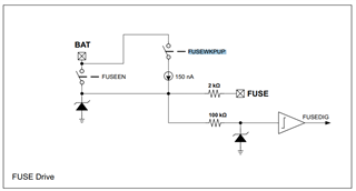

The customer is asking what this 150nA means?
Why the test condition is V_AFEFUSE=VSS?
From my understanding, now FUSE pin is 0.
How could there be internal pullup?
Hi Fabio,
150nA means nano Amperes. 10^-9
See below the FUSE pin equivalent circuit.
