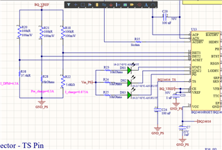

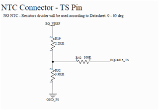

Hello, I tested this circuit, when charging the battery pack (3s with BMS) DS1 indicator LED is on.
Before the battery reaches its full charge, the DS1 indicator LED blinks, but even after a long time, I couldn't notice it finishes charging and the DS2 LED is ON.
Is this normal behavior? is something preventing the controller from continuing charging and making it do it in intervals?
