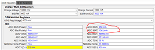

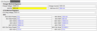

    Charge current is 822mA
    I connected the EV2400 module to see the data via the BQSTUDIO application. When there is a 12V input source, the "ADC IBAT" register appears to be 450mA on the BQSTUDIO. I also connected an ammeter to the battery. The ammeter shows 820 mA.
    Why does ADC show  450mA on BQstudio application?

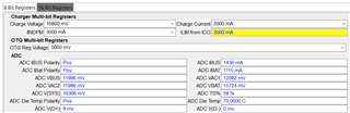

    @Charge current setting is 2A  but battery doesnt draw 2A
    @ İnput source is 12.5V
    @ input source 19V

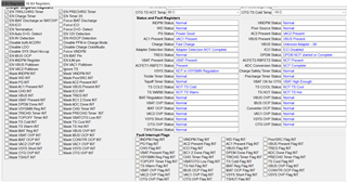

  • Hi eso,
    Can you show me the status and fault registers from the 8-bit tab?
    Jeff

    According to calculation, ADC is reading incorrectly,  ( 12 V * 1,28 A) / 16,4V  = 0,936 A
    I think, the switching signal seems to be OK, but when boosting it is not reading or adjusting the current properly. strange situation :)
    There might be something I missed.
    1. picture: ADC Registers
    2.Charger setting registers
