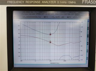

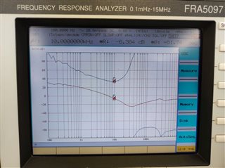

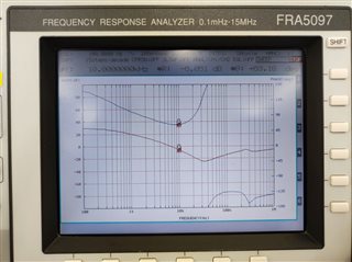

I need to evaluate phase margin and gaon margin with TL783 and similar type of regurators.

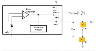

I will use FRA equipment abut I could not see where a 50 or 100ohm resistor should be populated to input sine wave from FRA.
Could you advice on this question?
In general , the resistor is populated between Vout and Feedback terminal but I'm concerened that TL783 has adjust terminal and
voltage between Vout and Adj will be kept to be 1.25V therefore sine wave might not be injected.
