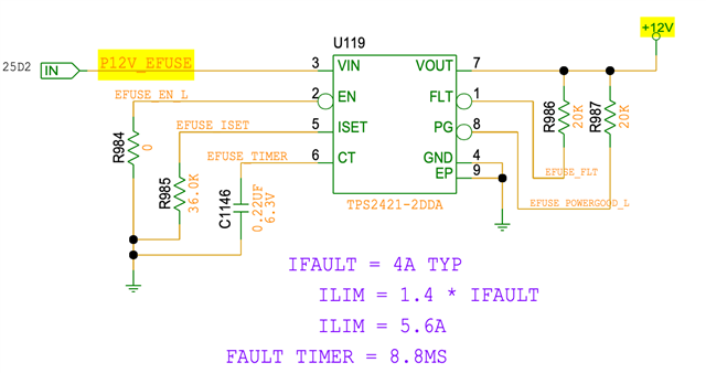

Hi TI experts,
In my design, i have put TPS2421-2 as current limiter after a flyback converter. Below is the schematic.
P12V_EFUSE comes from flyback output. +12V will be provided to downstream DC-DC converters.
As EN is held low, that means +12V starts ramping once P12V_EFUSE crosses the UVLO.
Does below design work? Is there any risk that both input and output are rising simulataneously?
