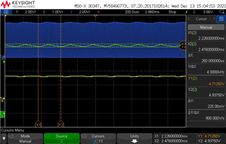

  • When I added capacitor much near to U1 IC with same configuration above (output capacitor to 22uF instead 47uF (i.e., 22uF *8 + 4.7uF *4 + 10uF = 206uF, Effective capacitance at 5V = 206uF * 0.55 = 115uF).
    Resistor Divider - 49.9k (upper) & 6.8k (lower), Cff = 470pF (calculated from that calculator excel) + 47Ω in series, IC in PWM mode.
    The problem of higher ripple moved at 0.8-0.9Amp load. At 0.6A load, output voltage is 4.96V (<20mV ripple), At 0.8 & 0.9A load output voltage reduced to 4.84V with higher ripple around 200mV and at 1Amp output voltage is 4.95V with 20-30mV ripple (stable).
    Here is waveform when high ripple. Yellow is Input 3.3V, Green is Output V, blue is SW node pin. Same ripple replicates in Input voltage. We have tried changing input source from our system supply to external DC source (6Amp current limit). Added bulk capacitor at input, too. But same observation.
    Then onwards,
    we have made iteration with same all 22uF output cap (115uF effective total), Resistor divider value reduced to 8.25k + 1.1k, Cff = 3.3nF + 47Ω.
    Supply working well. Ripple <20mV in all load condition. Load regulation is 2-3% for 1A load... We have checked same in two boards and thinking to go ahead with this
