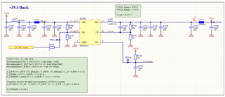

I have made a custom design with the part XTPS564252DRLR (Pre-Production version of TPS564252). Everything works perfectly so far (see schematic in the appendix). In addition, the eFuse TPS259824LNRGE is located in front of the buck converter.

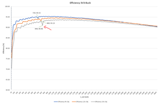

Then I measured the efficiency curve for U_in equal to 9V, 12V and 15V (L304 removed for this). I noticed that the higher the input voltage, the greater the notch/glitch at the lower currents (see image below). Is this normal behavior of the buck converter or what else could be the reason?

Schematic:
Efficiency curve:
