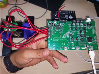

I designed a BMS Board based on the BQ40Z80 IC. Despite using a schematic similar to the one provided in the BQ40Z80EVM manual and configuring the BQ40Z80 according to the register configuration instructions in the datasheet, my board establishes communication with BqStudio. However, it fails to execute Charging, Discharging, or even retrieve the battery state upon pressing the 'display' button. Consequently, I acquired the BQ40Z80EVM with the intent of replicating the configuration to identify whether the issue lies in the design or the configuration. Regrettably, the BQ40Z80EVM is experiencing communication issues with BqStudio, further complicating the troubleshooting process.
when attempting to connect  the Bq40z80EVM to a computer using either the on-board Ev2400 or an external EV2400 (ensuring that the jumpers are correctly configured as specified in the manual), there's no successful connection between the BQ40Z80EVM and BqStudio. I've tested this with an alternative computer, but the problem persists. Notably, my BqStudio 1.3.101 functions properly, indicating that the issue likely lies with the BQ40Z80EVM. I've attempted to bring the board out of Shutdown mode by following the manual's Wake-up instructions, yet I'm encountering the same connectivity problem. ( i thaught that mabe the BQ40z80Evm is in the shutdown mode so i did the wake-up to make sure).
What could be the solution to this problem? The BQ40z80EVM is brand new and has never successfully established communication.
thank you.

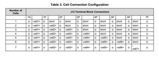

    How many cells are you attaching to the bq40z80EVM and please confirm that it matches the orientation below with the unused terminals shorted?
    Also, can you please tell me what configurations you are aiming to achieve, along with how they are configured on the EVM so I can attempt to recreate the issue?

    I'm currently utilizing a 6-cell configuration based on the table provided. Regarding your second question, the BMS board I've designed serves the purpose of safeguarding the cells against overcurrent, overtemperature, overvoltage, undervoltage, etc., while also providing visibility into the battery level.

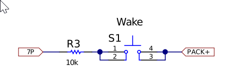

    Understood, regarding the bq40z80EVM connection issue, can you tell me when you are holding the wake button upon start up? Occasionally, the wake button needs to be held as bqStudio during the loading screen with the device powered below to recognize:
    Can you tell me if there are any connections to PACK+ and PACK- as well?

  • Hi Anthony,
    I attempted to press and hold the "Wake" button during the loading screen, but the issue continues.
    The Pack+ and Pack- aren't connected as depicted in the image below.
    The .gg file for the configuration is attached herewith.

    If you are using the attached EV2400, the J18 configuration needs to be changed from EXT SMBD to EV2400 SMBD.
    Also, a shorted connection has to be made from the 6P to 7P connection points.

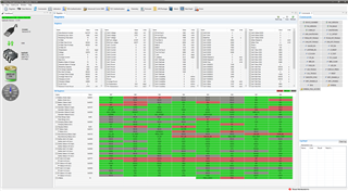

  • Hi Chahin,

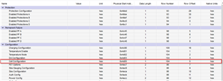

    This is occurring due to the Cell Configuration register not being set to represent the amount of cells that are attached.
    It can be found and configured within the Data Memory -> Settings in bqstudio:
    Anthony Baldino
  • Hi Anthony,
    Thank you for your response.
    For my own BMS board, I am pretty sure that I configured the cell (06) correctly. However, I don't know why it didn't change when I exported the .gg file.
    Regarding the BQ40z80EVM, it shows a connection for only a few seconds, so I can't access the register configuration to set up the Cell Configuration Register. I read in the manual that the 'Wake' button connects 'PACK+' to 'BAT+' temporarily. I'm considering permanently connecting 'PACK+' to 'BAT+' with a wire because, while I'm holding the 'Wake' button, there's communication between the board and BqStudio. When I release it, the communication is interrupted (as shown in the video).
    The manual states that the 'Wake' button should be held to "temporarily" connect 'PACK+' to 'BAT+'. But it seems like these two pins should always be connected for communication, which is illogical because when we want to charge the cells, it becomes impossible for the 'PACK+' pin to be simultaneously connected to 'BAT+' and the charger or power supply. This could undoubtedly cause damage to the devices.
    So, could you please confirm if, for the BQ40z80EVM to work, the 'PACK+' and 'PACK-' pins should be permanently connected to a power source or charger? If so, what should I do if I want to use the BMS Board on a mobile tool that is not meant to be permanently connected to a charger?

  • Hi Chahin,
    After the cell configuration is changed, is the device still entering sleep mode? Typically, once this configuration is done the device should stay awake without the connection between PACK+ and BAT+ unless there is another configuration issue.

    The device is still entering sleep mode despite changing the cell configuration, so I believe there might be another configuration issue.

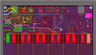

    The BMS Board aims to safeguard the 6 cells from overtemperature (using only TS1), overcurrent, overvoltage, and undervoltage in both charging and discharging phases. Each cell has 3.87V and 3.95Wh. Additionally, there's a display button similar to the one in BQ40z80EVM-020 for capacity visualization.
    The BMS Board I designed mirrors the schematic provided in the BQ40z80EVM-020 Manual (excluding the PDSG option), so the pin configuration aligns with the BQ40z80EVM-020.
    I've attached the file representing the schematic of my BMS Board if you require it.
    I truly appreciate your cooperation and support; you've already aided me in establishing a connection between the BQ40z80EVM and the BqStudio. Thank you, Anthony. I genuinely rely on your help.
    Chahine SAKKA.
    BQ_EV_BoardSCHEMATICS.pdf

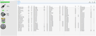

    I have attached two screenshots from BqStudio showing the voltage and current readings, as well as the register readings.
    Kind regards,
    Chahine SAKKA

    In fact, there is good news: the BQ40z80EVM is no longer entering sleep mode and remains connected even when the pack+ and pack- aren't linked to a power supply. However, a new issue arose: the pack+ is now consistently connected to the BAT+ as if the 'Wake' button is continuously pressed. I'm unsure why this is happening. When attempting to apply voltage to pack+ and pack-, a short circuit occurs, which seems logical since the power supply is directly connected to the cells through PACK+ and PACK-.
    I'm eagerly awaiting your response on whether it's normal for pack+ to always be linked to bat+. If so, how can I effectively charge the cells?

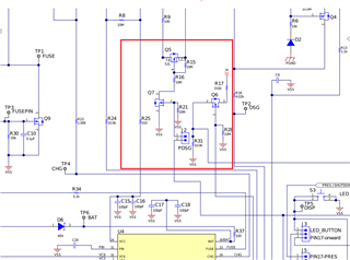

  • Hi Chahine,
    I do not believe that this constant connection between Pack+ and BAT is normal. Seen from the schematic below, the only main connection between PACK+ and BAT is the wake button which is only meant to be a temporary connection for the configuration to be set.
    Regarding how the cells are charged, this is done through the FET system that is connected to the gauge that is also connected to the pack connections. There should be no contact between PACK+ and BAT in normal operations.
    As I look through the log file, is it possible for you to check the voltage passing through the wake button while being pressed and while not being pressed to see if there is a fault occurring?

    Is there a reason that the Cell 2 Voltage is about 300 mV less than the other cells?
    Anthony Baldino
  • Hi Anthony,
    The video attached shows the voltage across the 'Wake' button while pressing and releasing. Since it gives 0V, it means there is always a connection between PACK+ and BAT+. I will try to remove the button and see if there is a hardware problem in the button itself by testing the continuity with the multimeter between the button pads.
    While downloading the attached log file, I pressed the 'wake' button.
    Regarding Cell 2, I think it's been discharged. I measured it and got 3.0V instead of 3.87V. So, I will replace it.

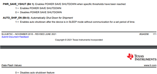

  • Hi Chahin,

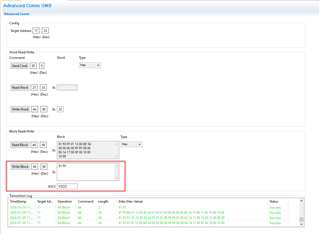

    Can you please change these two registers to low and see if it effects the gauge going into shutdown? They can be found in Data Memory -> Power Configuration.
    Anthony Baldino
  • HI Anthony,
    I beleive that is not the root cause. When checking the 'power config' register, I noticed that these two bits were already set to low, as depicted in the screenshot
    Chahine SAKKA

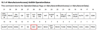

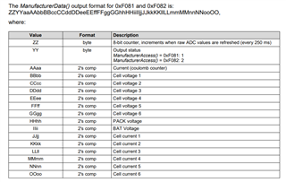

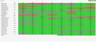

  • Hi Chahine,
    In the log file sent above, Cell 3 and Cell 5 are reading 0V.
    Also, this log states that OpStatA is 0x02D89. This indicates that SDV is high, which means that shutdown is being induced by low battery stack voltage.
    Can you please confirm if this the same issue that keeps occurring?
    Anthony Baldino

    Also, can you please check if there is a short occurring across the wake button?
    SysPres should be tied to pack during charge and discharge testing, or the NR bit can be changed to 1 and SysPres can be left open.
    Anthony Baldino
  • Hi Anthony,
    Following the disconnection between SysPres and PACK, and setting the NR bit to 1, the connection between the Board and BqStudio has been successfully established. This has resolved the issue of a persistent connection between PACK+ and BAT+, and the board has not entered sleep mode since then.
    Furthermore, there is no occurrence of a short across the wake button.

    Please find attached the video illustrating the phenomenon. Notably, there is no direct connection to PACK+ and PACK-, yet a voltage of 22.7V persists across them. also, there is a continuity between PACK+ and BAT+,
    Concerning CHG and DSG, I haven't been able to conduct a charge cycle as I'm unable to connect a power supply through PACK+ and PACK-.
    In the attached files, you'll find a screenshot depicting the registers. for example, The ASCDL bit of the "PF Alert A+B" signals a Short Circuit during Discharge latch. Consequently, I haven't attempted to discharge the cells. Additionally, the ASCCL bit indicates a Short Circuit during Charging.
    There is also other flags indicating other types of errors, which i beleive didn't exist in reality,
    please let me know if you require any additional files or information.

    Regarding the current continuity across PACK+ and BAT+, is it possible for you to share the layout files for this design? Currently, I don't see any where in this schematic that could be causing this.
    Anthony Baldino
  • Hi Anthony,
    I hope this email finds you well. Please find the hardware design attached to this email. Additionally, I've included a screenshot of the design in case you encounter any issues opening the .PcbDoc file.
    Concerning the continuity across PACK+ and PACK-, it appears that this issue is not solely attributed to the hardware design, as a similar problem occurred with the BQ40z80EVM. I took the initiative to replace the BQ40z80 IC with a new one.  The "PF Alert A+B" high bits problem was resolved, and it was determined that a firmware I downloaded was causing the issue.
    However, the "COV" and "OCC1" bits remaining high. I suspect the "OverCurrent in Charge" bit may be related to the 23V across Pack+ and Pack-, but I haven't identified the cause of the "COV" bit.

    Regarding the COV issue, I believe it is determined by the individual cell voltages. Seen below are your thresholds for this protection:
    Seen in the log file, your cells are around 3.75V. I believe you can change these values to get rid of these protections.
    Regarding the hardware, it is difficult to see if there is a continuity between PACK+ and PACK- to a line that could be causing this high voltage. Could you tell me if the voltage across PACK+/PACK- is the same as the total voltage from the cells?
    Anthony Baldino

    Sorry for the confusion regarding the PACK+/PACK- issue. I have received outside council regarding this issue and have been told this is the normal function of the gauge based on whether the FETs are on:
    If the FETs are active, the voltage across PACK+/PACK- will be representative of what is on the BAT line (22.4V in this situation). if charging is occurring with a charger attached to pack, this voltage will be greater than what is on the BAT line. When discharging, the voltage will be lower.
    If the FETS are not active, the voltage across PACK+/PACK- because the FETS should be closed.
    Please let me know if you are seeing abnormalities to this information on your board and we can address the issue from there.

    Regarding the calibration process. Could you kindly guide me on locating the ManufacturerData() register within BqStudio?
    Chahine SAKKA
  • Hi Chahine,
    These values can be found by using the Advanced Comm SMB function in bqStudio.
    Using these values below, you can access different data:
    In the example below, I accessed 0xF081, where 81 F0 is written to 44 and read back from 44:
    Anthony Baldino
