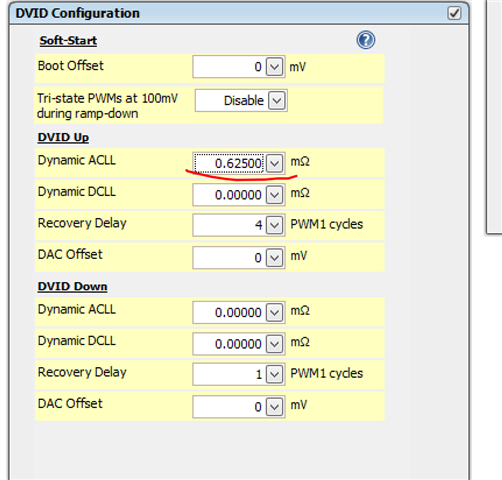

    We have complete DVID test cases, here we changed Dynamic ACLL to 0.625mohm to pass all the DVID cases.
    When you tune parameters, please keep DVID test NOT impacted as we don't have resource to re-test DVID cases. :(

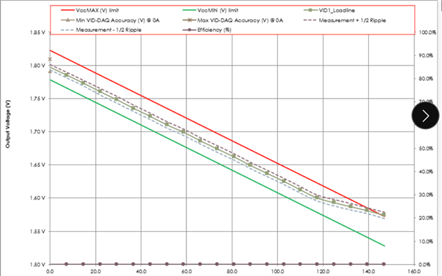

    DCLL 1.7mohm is hard requirement by Intel CPU.
    Here is what we observed while keep DCLL=1.7mohm, while modify ACLL from 1.7mohm to 1.53mohm.
    The slope got changed at high current.

  • Hi Neo,
    I was able to reproduce these results on an EVM pulling 140A. For the ACLL DCLL mismatch I am seeing the Static LL issue from ACLL ~1.5mOhm  to ~1mOhm with fixed 1.7 DCLL, going below 1mOhm ACLL the static LL behavior goes away. Can you try running the test below 1mOhm ACLL and see if this fixes the static LL and is able to pass transient on your end? As a heads up, going from 1.5mOhm to 0.9mOhm ACLL may require slightly altered loop compensation parameters to pass.

  • Hi Ryan,
    Changing ACLL to below 1mohm does not work for my case.
    With 0.85-0.95mohm ACLL, i do see static LL passed, but transient LL Vdrop still failed with 15mV lower than spec.
    However when reducing ACLL from 0.85mohm to lower value, we got Transient LL passed but Static LL failed again.
    The window to pass both Static and Transient LL test is quite tight. I am not able to pass both tests with margins.
