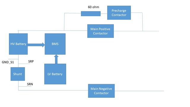

Our BMS system consist of BQ79656-Q1 as base device and six BQ79616-Q1 devices.
We have connected HV battery with shunt current sensing, charge-discharger and contactors.
There are three contactors
Positive line contactor, precharge contactor and negative line contactor.
The base device communicate to host MCU over UART lines and using isolator ic ISO7342.
During precharging, we are seeing that BQ79656-Q1 is alone going into sleep mode without giving any sleep command.
Other slaves are not going into sleep.
This is leading to Daisy communication fault.
We have given wake up repeated commands to keep it in wake state, however there is still a daisy communication fault.

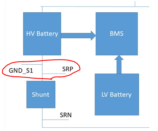

So from above observation we are suspecting that some noise is entering through SRP and SRN lines through charger after turning on the contactor.
However, we have 10 ohm two resistors and 0.47uF capacitor in SRP and SRN line.

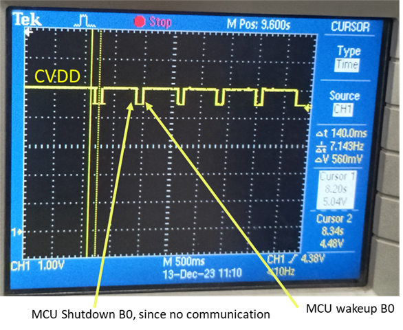

During this interruption CVDD is falling from 5V to 4.3V and DVDD is falling from 1.8V to 0V.
The below waveform is of CVDD. It falls down from 5V and goes to 4.3 V.
Our Ch1-ve is connected SRP and GND_S1 while SRN is connected to load side.
Can you please tell us how to get rid of this noise?

    So it seems like this noise is causing an undervoltage error on the BQ79656 device. When the voltage drops on CVDD to 4.3-4.65V that is low enough to trigger an undervoltage event. When DVDD undergoes an undervoltage event, a digital reset is triggered, which could be what is happening here. After going to sleep does the device wake up again? You described a filter for each of the SRN/SRP pins; is there a capacitor between the two pins? This can help with common-mode noise. If possible, can you share the system schematic?

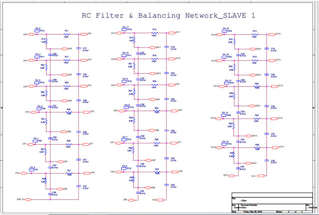

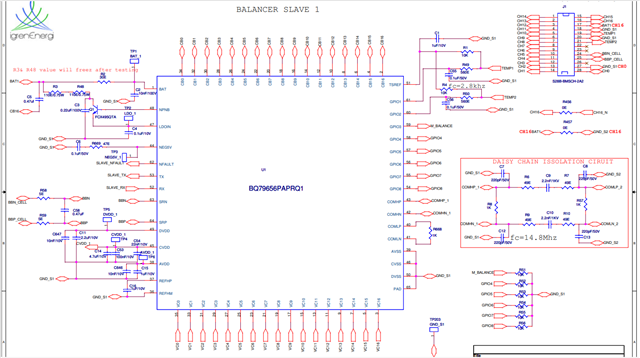

    Yes there is a capacitor of 0.47 uF between SRP and SRN lines.
    I am sharing the relevant diagrams here.
    Do you need any DSO waveforms for more information?

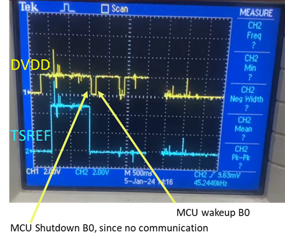

    Apologies for the delay and thank you for the additional information. I have a couple more questions:
    1. What do you observe on the TSREF pin during this unexpected behavior? Do any of the other supply rails (AVDD and DVDD) exhibit similar behavior?
    2. What is the value of the register COMM_TIMEOUT[CTL_ACT]? This register controls the communication timeout feature.
    Nancy

    I am also sharing Tsref and DVDD waveforms here.
    It goes down without giving sleep command.
    Blue - Tsref and Yellow - DVDD

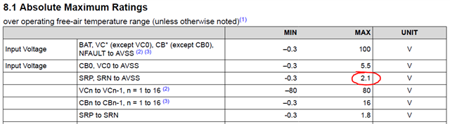

    I see the voltage of SRP to GND_S1 is about 6V. It is much higher than AMR 2.1V.
    I think it should be a very low voltage. Why the voltage is so high?

  • "Our Ch1-ve is connected SRP and GND_S1 while SRN is connected to load side."
    What does "Ch1-ve" mean?
  • Hi Harrison
    -" Ch1-ve " means HV-ve of the battery.
    In other words negative terminal of the high voltage battery.

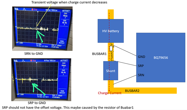

  • It seems the SRP and SRN‘s noise related. Could you capture the waveform of SRP to GND and SRN to GND when 656 goes to sleep.
    Try to disconnect SRP or SRN for confirming which wire is causing the issue.
    The under voltage of AVDD and DVDD will cause 656 reset. You can capture the waveform of AVDD, DVDD and LDOIN.
    Increasing impedance of  SRP and SRN is one solution. I suggest first confirm the root cause, then give detailed solutions.

    I think the MCU shutdown and wake up B0 repeatedly caused this waveform.
    The question is why the communication loss? I guess the noise on the GND flipped the data on the UART, causing communication failure. MCU can send COMM CLEAR when there is no noise, observe whether communication can be recovered. During debug, CTL and CTS must be disable.
    The MCU continuously monitors the fault status in order to indicate whether the FAULT_SUMMARY have fault.
    If SRP/N noise is conducted to GND, it may affect UART communication.
    The following analysis is my guess. Check the  length and resistor of BUSBAR1.
